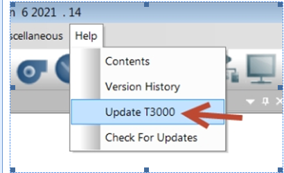

Please fix your HUM-C as followed steps .
Download and install T3000 on your PC , update to the latest version .
T3000 download link address :
https://temcocontrols.com/ftp/software/09T3000Software.zip
T3000->help->Update T3000 .
Link HUM-C and PC to the same router which can access to internet , run T3000->discover to find all HUM-C under local network tree,
Select Humidity and T3000->Help->Check for updates ->Download firmware and update , the latest firmware is REV75 .
