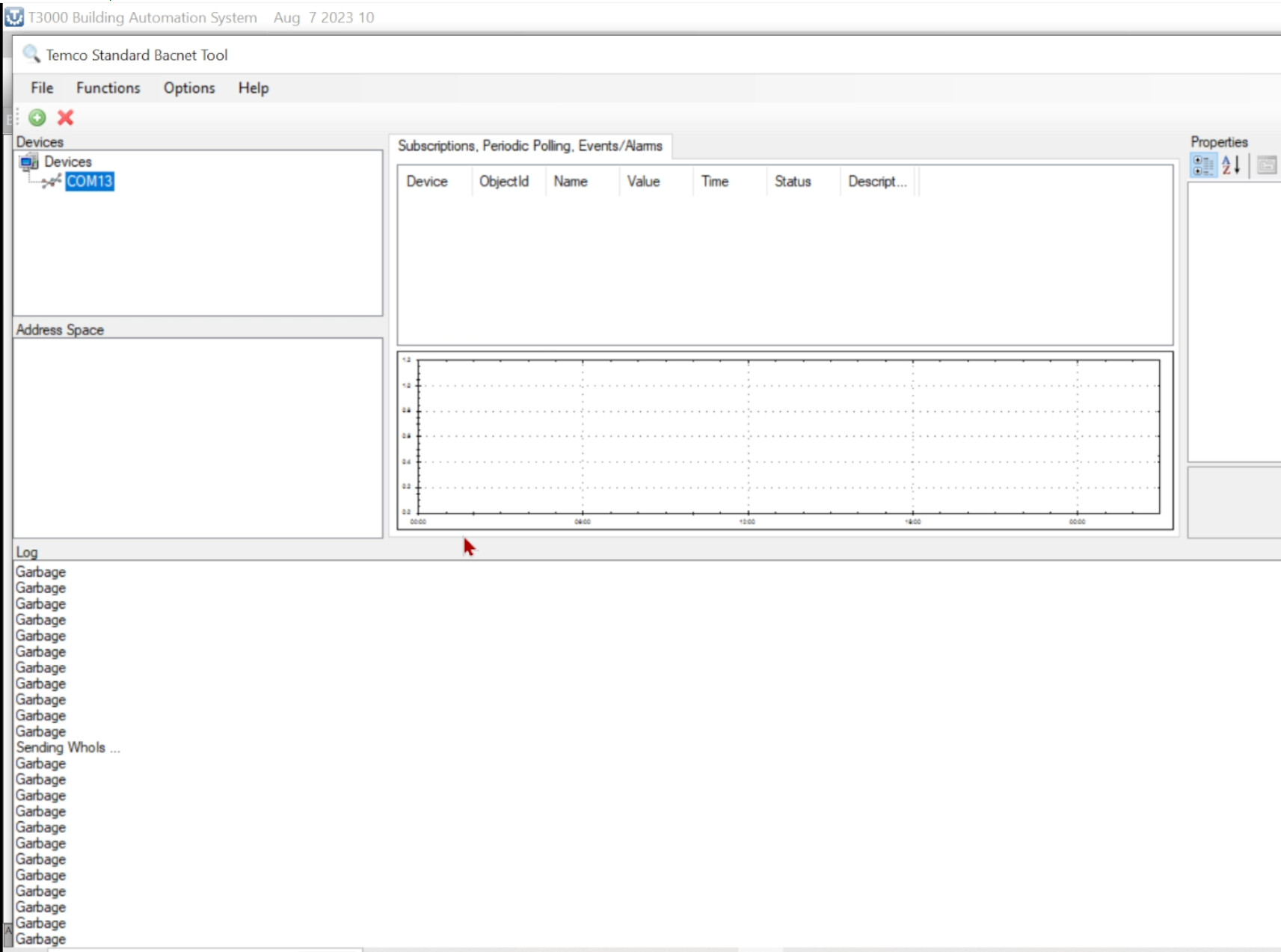

I reinstalled may T3000. Updated T3000 to Aug 7 again. I flashed this bootloader for AQ from this forum, and then flashed the 14.1 again. Still the same results. It sees something but does not go further. I would have expected after flashing bootloader and firmware that the persistent config should have been wiped out to only have modbus so I can configure the bacnet option again.
From your screenshots, it appears that your Airlab has been running the Bacnet protocol at 115200 baud.
I recommend that you use the Bacnet tool of T3000 software to change the Airlab protocol.
Tools->Bacnet Tool, click on the green plus ball, select the correct port and baud rate. Then click the “Add” button, follow the steps in the figure step by step, change “Protocol”'s “Present Value” to 0.
Then its protocol is changed to Modbus.
I don’t get to the stage of setting the source value prompt. It won’t connect to the device as shown in my screenshot above from yabe bacnet tool it says the output from the device is Garbage. I’ve tried many other baud rates, and all to the same effect = garbage on the terminal. This all started with the update button to 14.1 firmware.
apparently that bootloader now is only version 56. Do you have newer bootloader and firmware for the airlab? it came with 80, Things look like its worse, not getting anything out of this $170 box and i’m 3 weeks behind schedule.

Do you have a newer bootloader? Originally the Air lab had bootloader version 80 when I used update in T3000 for firmware 14.1. From the bootloader on the forum, that one installs bootloader version 56. I think there is a conflict that it sends garbage data. I was able to get the present value changed to 0, but now I cannot get add into the bacnet tool anymore, but it looks like I connected in modbus tool. It still does not detect in auto scan.
I tried this All nodes dialog tool and it seems I was able to manually add, and now finally back to start. Do you have a newer bootloader?
