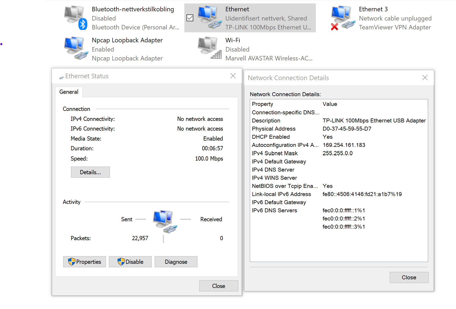

-show us what you see here at Tab1 for your PC network settings and maybe I can spot something.
Screenshot (7)

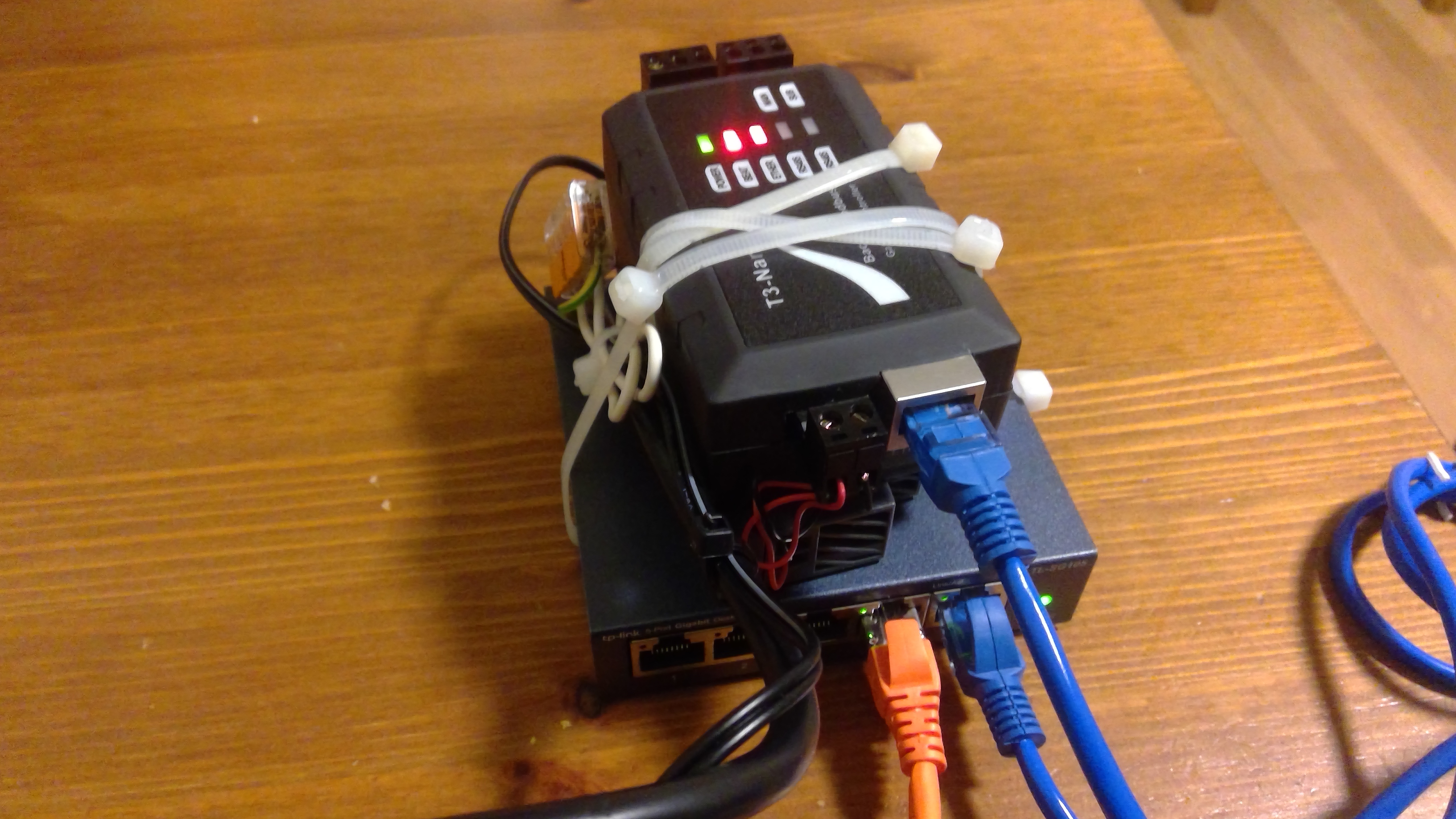

This its my situation. :upside_down_face:
In your test I assume your PC is connected to the orange cable, this means there’s no router in the system, just the simple unmanaged netgear hub. That’s a good simple test setup however there’s no DHCP server in this situation so the T3-Nano will assume the last IP address it successfully communicated with. The T3-Nano gets tested in the Temco Office with an IP address of 192.168.0.XXX so you could temporarily change your PC address to match. In my screen shots at Tab1 above the PC is set up at 192.168.0.222, you could do the same.
