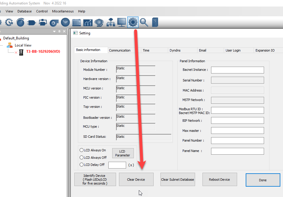

I am not fully following you there but its easy to start fresh, just connect to the controller, hit the gear icon for the advanced settings and then hit ‘Clear Device’

any way to delete the program off the T3 so i can save a new file with out it.
Just connect to the controller and then hit the ‘Clear Device’ button as shown. Now the device has no program in it. Hope all is clear.
