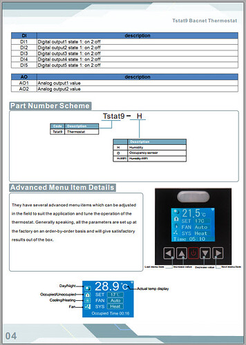

Interesting, not sure where you saw it becuase its a new product we havent mentioned much except for in some emails. I’ll have Arry post a preliminary data sheet here now.

What we have so far is up there, lower part of page 2. There’s Two lines coming in for the power, 90 to 240VAC. Then five relay outputs for the three speed fan & two valves. There is no modulating outputs and no spare terminals for sensors and so on, those will come later. Communications is over wifi only, no RS485 or other options on this either for now.
