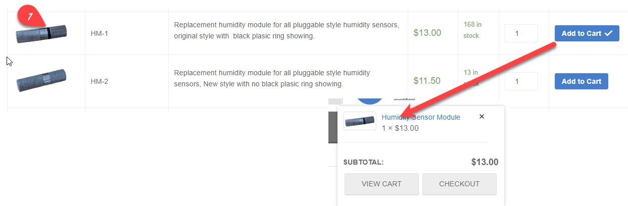

What is the item # to order to get a replacement screw-in sensor for the Hum-D unit? Mine is starting to give me erratic readings.
Please check the OEM section for some replacement bits there.
Maurice Duteau
Thanks Maurice. I went to that page and found a HM-W-S which is just the screw-in sensor and a short lead. But there’s no way to “add to cart”.
What’s the best way to purchase this?

Hum Sensor: Hmm, shopping cart seems to be working for me. You can order just the module at the end of the pipe rather than the whole module + pipe assembly. There are two styles, the original has a black plastic ring showing at Tab1 while the current version has no black ring showing, only metal.
