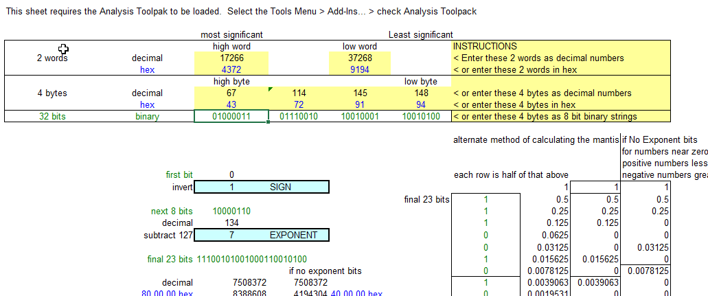

I have attached a spreadsheet that contains the calculations for converting two 16b words to a 32b float which works for the data received using MB_INPUTREG0 (High) and INPUTREG1 (low).
If anyone know how to calculate this in the programming area I would be really grateful

ieeefloats.xls (50 KB)

That’s a pretty complex spreadsheet but we’ll dig into it shortly. Thanks for your work so far with the products Chris.
