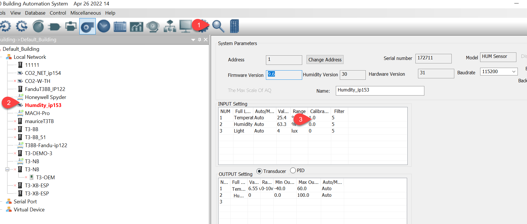

Please connect to the device with our T3000 application which you can download from the product pages. Depending on the device you will need either an ethernet cable or an RS485 converter to connect. Hit the magnifying glass icon at Tab1 to discover the devices then click on your device at Tab2 and you will see a dialog where you can add an offset for calibration at Tab3.

The user interface for the transducer is very similar, you can calibrate there in the same way.

For example, in that window i could not clearly identify the values for calibration in the temperature or the humidity of that sensor
Do i have to move 60-76 values? How to fine tune them?
