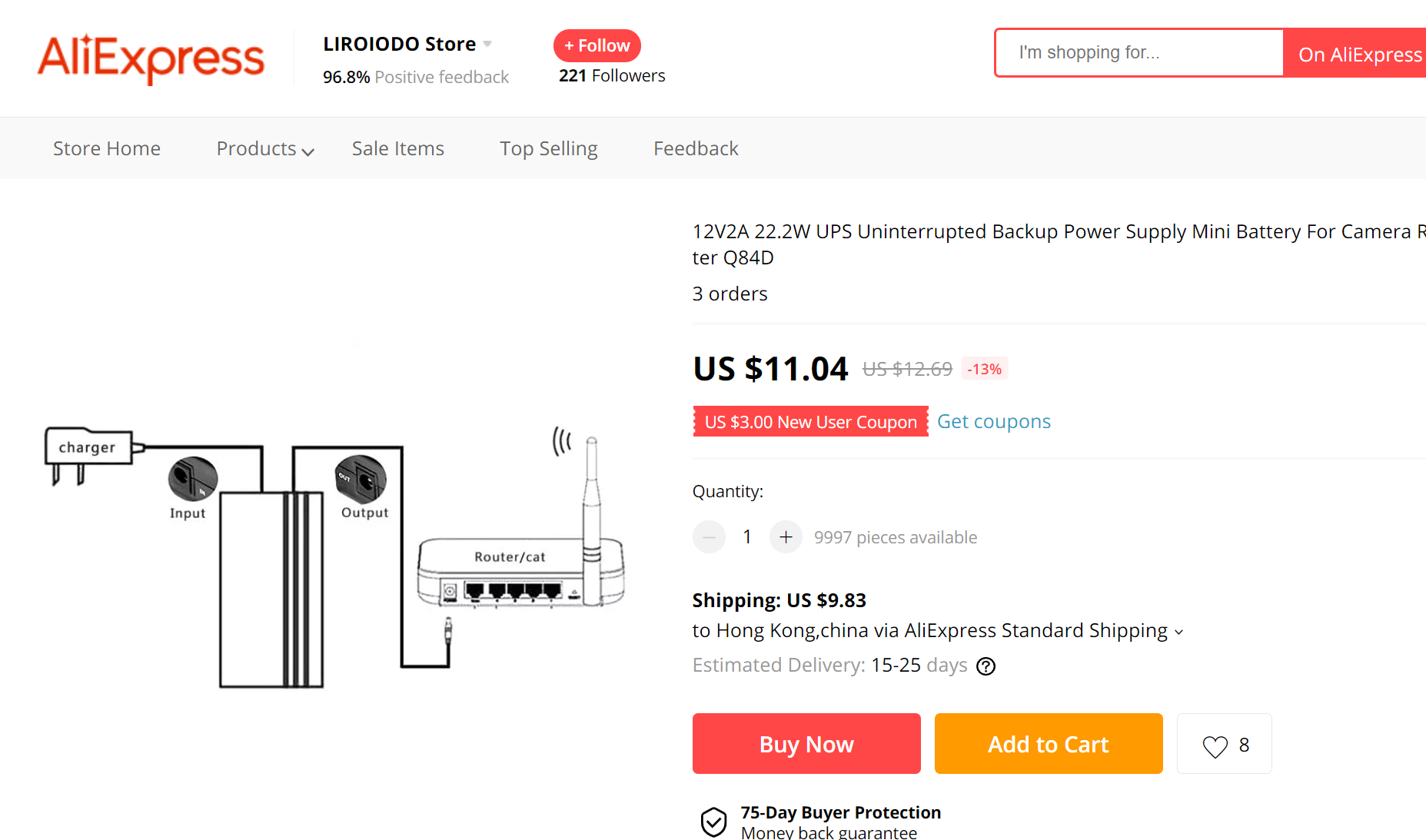

Another option would be to just get a low cost backup power supply, they are not expensive.
