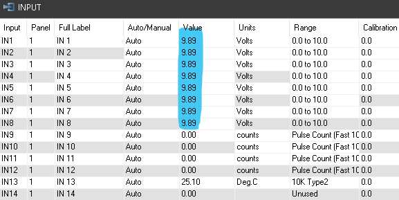

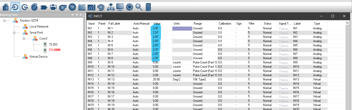

T3-oem only DC24V and RS485 connected. Controller AI reading voltage. That may cause issue?
There is a weak pullup resistor for the dry contact/thermistor excitation voltage. Set the input sensor type to ‘voltage’ and this excitation voltage will not be active.
