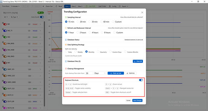

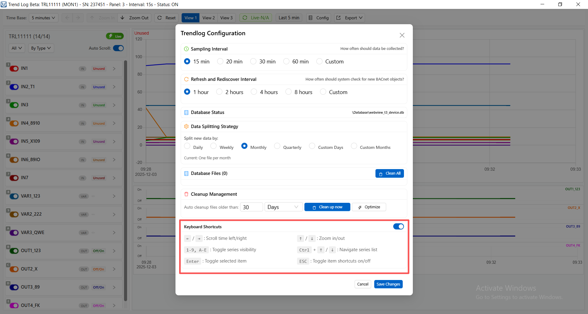

The data does get stored automatically in the trend logs, just list your IO that you want to log and it’ll be stored in flash automatically at the interval you define. This data is stored on board the device itself and will eventually get overritten so you’ll want to log in and get your data off periodically.
The data in our newest release can optionally also be stored into an SQL database, it needs a PC running on the network to do the logging.
