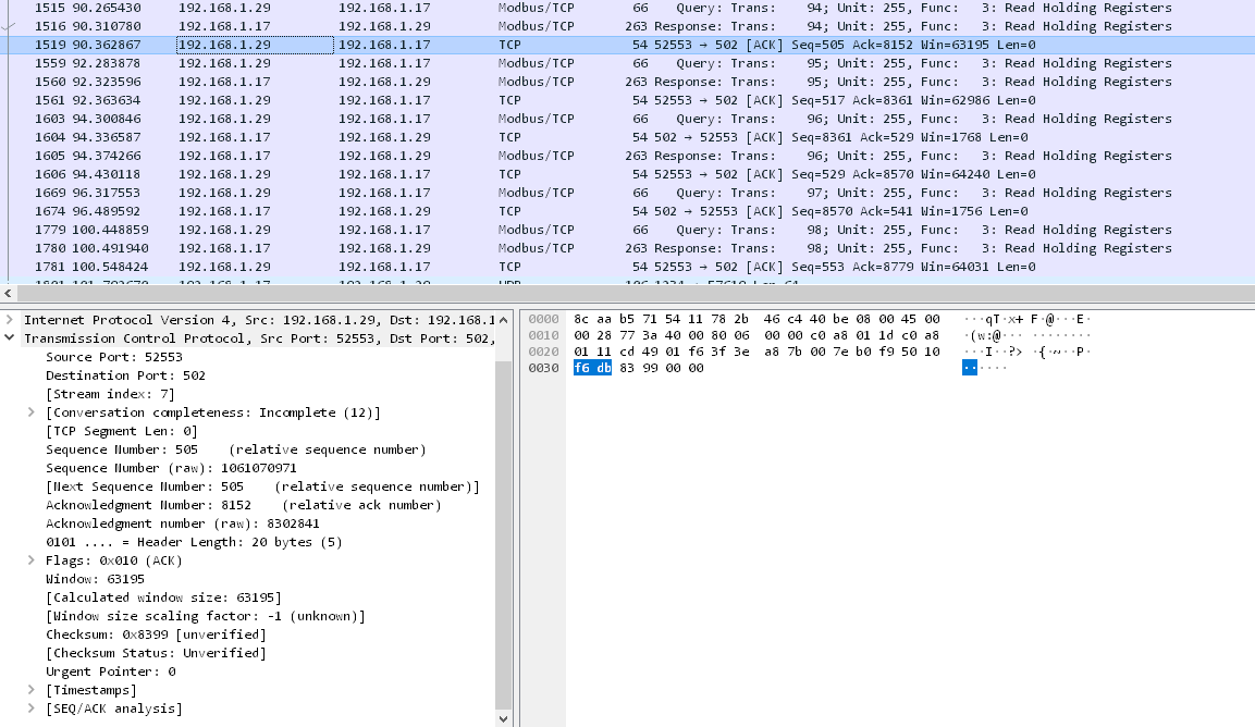

One of the things that we noticed in the last couple weeks is that it appears as if the responses from the TStat10 are not all in Modbus/TCP format and that there might be some sort of remnant TCP message being sent by the TSTAT10. The message is sent consistently from the TSTAT10 in response to a query and is directed back toward the 502 port so I would expect it should be Modbus/TCP or should not exist at all.
The same also appears to occur from the T3000 software to the TStat10
I have the actual capture if that helps.

They are the normal ACK package in ModbusTCP protocol

If that is what they are, then the problem is that the they may not be compliant to the MODBus protocol. They are showing as TCP rather than MODBus according to WireShark. It also might explain some communication issues that we hit because with different MODBus clients we get a reproduceable timeout even though the connection is good.
I think the message format needs to be analyzed to determine how the messages differ from what is expected by MODBus TCP. If this is a normal type of follow on message, then I am not familiar with it

This is a normal packet, Other non-wifi products are also similar TO packets. I have explained that the communication of WIFI products will be slower than that of normal network products because the RS485 to WIFI module is used. Our new TSTAT10 will no longer use modules.

Can you reword the phrase “This is a normal packet, Other non-wifi products are also similar TO packets.” because I do not know what you are attempting to tell me. What do you mean by normal and TO packets? My point is that I would expect the ACK packet to be a MODBus packet.

Can you address why the ACK packets sent by both the T3000 software and TStat10 when communicating are not Modbus TCP format according to the protocol decoding of Wireshark? Your comment about “As for ACK packets, these are sent by the software itself” does not provide an explanation about these packets.

wireshark classifies it as TCP, we dont have a lot of control over how wireshark classifies it. We support modbus/tcp and BacnetIP, this has been debugged in hundreds of environments and can be trusted, That said we’re always on the lookout for exceptiions.
As shown in the screenshot we use modbuspoll.exe, seems it communicates well at scan rate 500ms. Use the block read command to reduce the number of packets, this will get you more registers per second overall.
