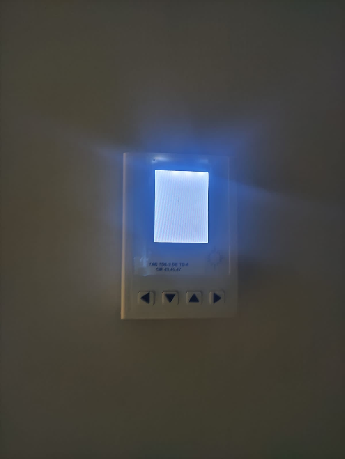

I have a thermTermostat10 and was working preatty good but a few days ago start blinking the display does anyone know why.
Does It need an update?
Thanks
Regards
It seems to have entered the bootloader mode. I’m not sure how it got there. I’m sorry that you have to use the ISPtool.exe to update it. If you dont know how to do it, you can contact us.
chelsea@_@temcocontrols.com(delete _@)
Thanks a lot.
I’ll use the isp tool to update it and see what happen
