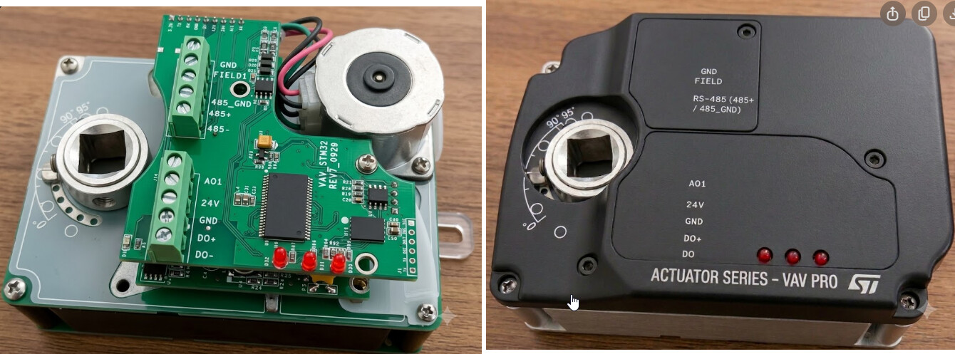

Here’s a preview of where we were at. I wasn’t able to find a sample of the real cover, but you get the idea.
We’re now using the ESP32-S3 with 16M rom and 8M ram which gives you plenty of room for the VM. You will have some work with the porting but with the AI assisted development these days it should go quick. I can send you a sample in about a month.

The DP sensor is on the lower board. I’ll see what we can fit into this current enclosure and we can discuss more soon.
