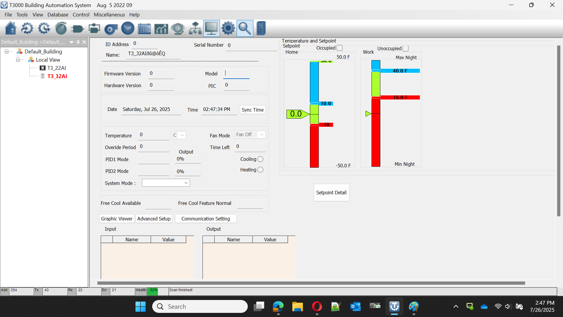

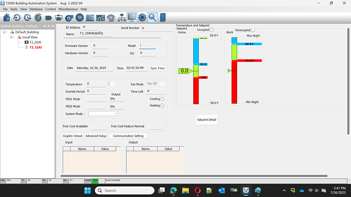

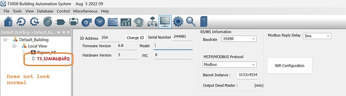

I have a supposedly new device that does not report on scan for Ethernet but when I connect RS-485 it is discovered but the Name displays as"T3_32AI
ðœû@òÊQ" and S/N 244081. When I try to display the Inputs, the T3000 response is “Device does not have in Input Grid Display”. I also have a T3-22i that works fine on both Ethernet and MODBUS with T3000. Is there a factory reset or firmware replacement I can do? Thank you for your support.
JP In Detroit MI
Since you can connect to T3000 via RS485, you can check the IP settings to see if there is any IP conflict, or confirm if it is automatically obtained. The code of T3-32AI is the same as that of T3-22I, except for the number of inputs.

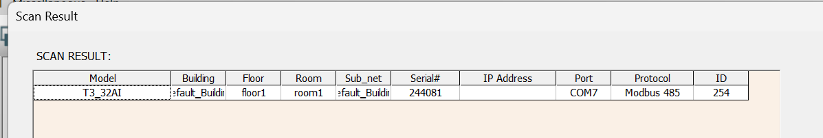

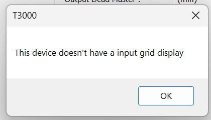

Thank you, Chelsea.This is what I see with Discovery and I’ll get a snap of the Local View of this device too. I also get a “Device doesn’t have a Configuration Display” Dialogue box. I also get “Divice doesn’t have an input grid display” when I try to see input config. Unexpected indeed

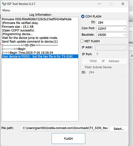

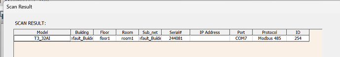

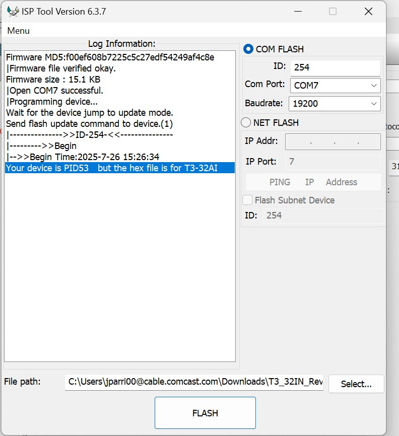

I thought I’d try flashing the FW and received an interesting response in T3000:
The firmware shown in your screenshot is the outdated T3-32AI. Product number 53 represents our new T3-32AI-ARM. We haven’t yet incorporated it into the FTP’s automatic update system. We will complete the process as soon as possible. There is a new ARM version of the firmware included in the attachment.
T3_32AI_REV68.hex (330.5 KB)

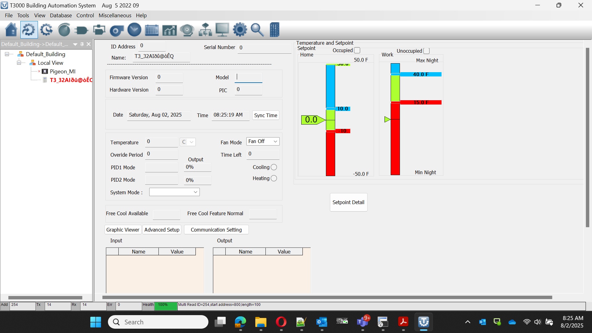

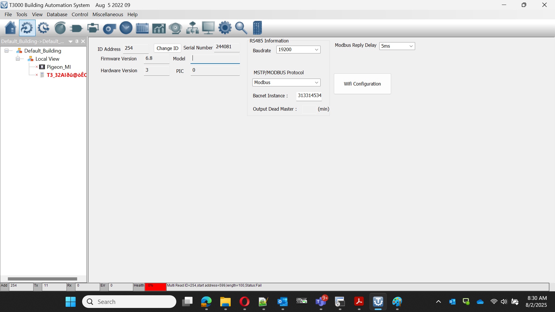

Thank you, Chelsea. I loaded the FW without issue but it still looks the same and does not display inputs nor is there any Ethernet detection. This is a new device (S/N: 244081) and I’m trying to configure it for a new project. Should I pursue an RMA for replacement? Please advise and I do appreciate your responses and help!

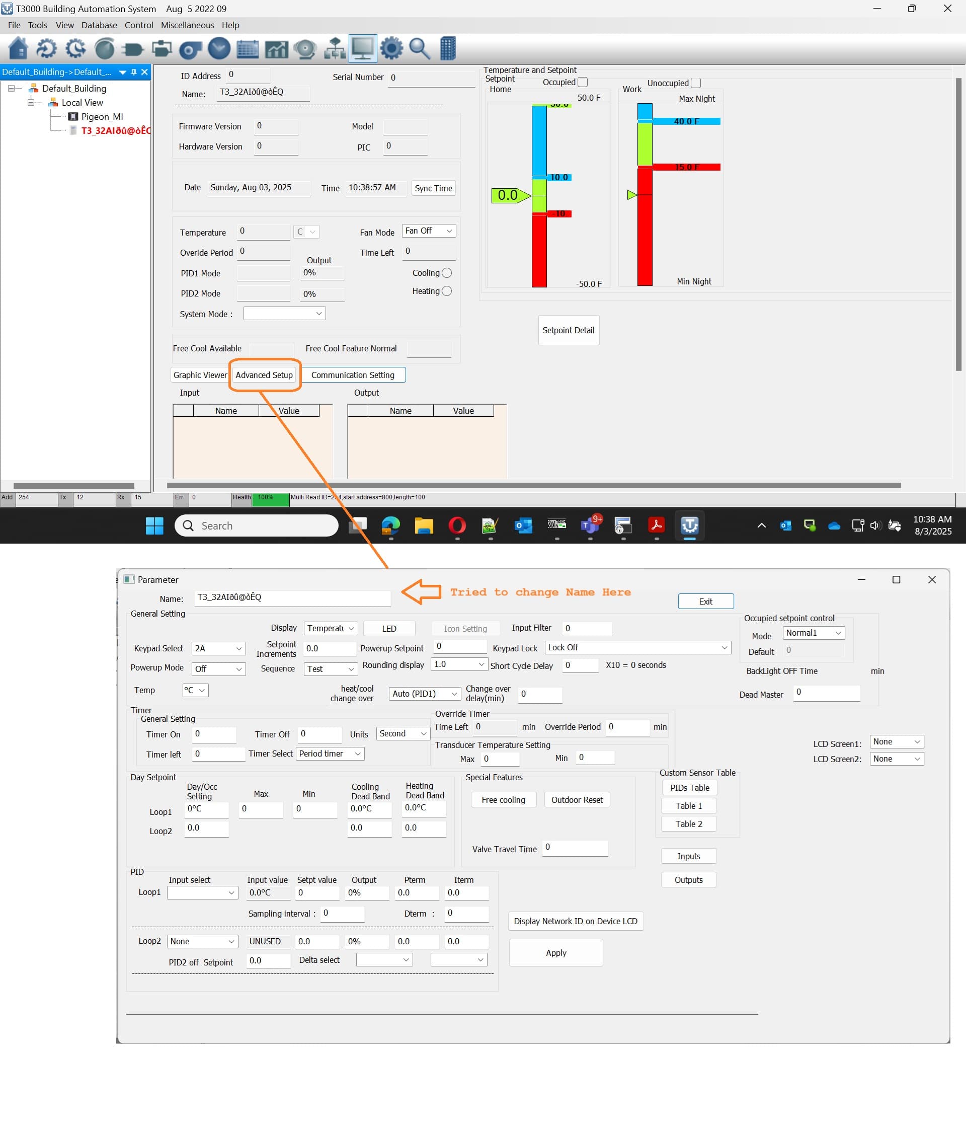

I forgot to add this observation of the Local View. It leads me to believe this has a corrupted configuration that cannot be corrected by the FW refresh I accomplished. Thoughts?

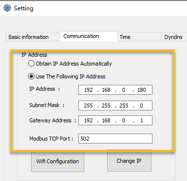

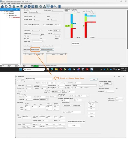

Ethernet: Can we see the IP configuration settings.

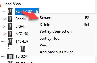

Garbled Name: Can you rename it?
Thank you! Here’s what I’m seeing and this is definitely not acting like a 22I!

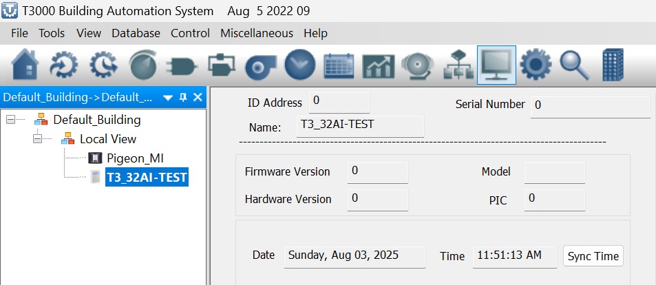

I tried it your way, Maurice and yes, it worked.

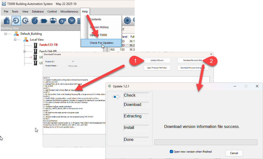

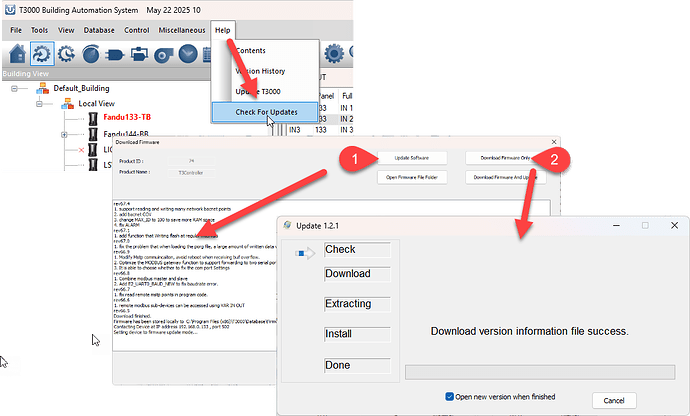

I noticed that your T3000 is quite old, we added this T3E-32 expansion input model last year so you will need to update T3000 as shown at Tab2.
And just for reference, you can also update the device firmware at Tab1.
