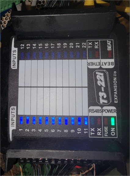

Also please explain what triggers the LEDS on or off when the inputs are configured to read thermistors. On one of the units that I bought the first 11 LEDS are on all the time, and the other 11 are off.
