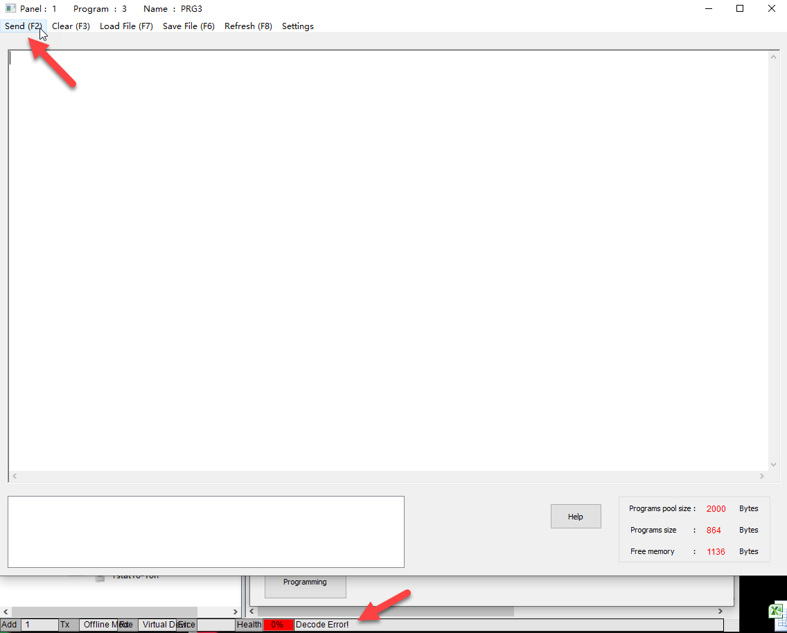

    a) having previously sent and saved a program, sometimes I try to re-open a program and all I get is a blank screen - none of the previously sent/saved code!
b) I have a partly edited a program (PRG3) with a reported size of 1062 bytes when last “sent” - although it shows 864 bytes in main Program window. When I try to re-open this program, the blank PRG3 window opens, but rather than the code loading, T3000 simply crashes out. Every time (>10 tries) ! I cannot even clear PGM3!

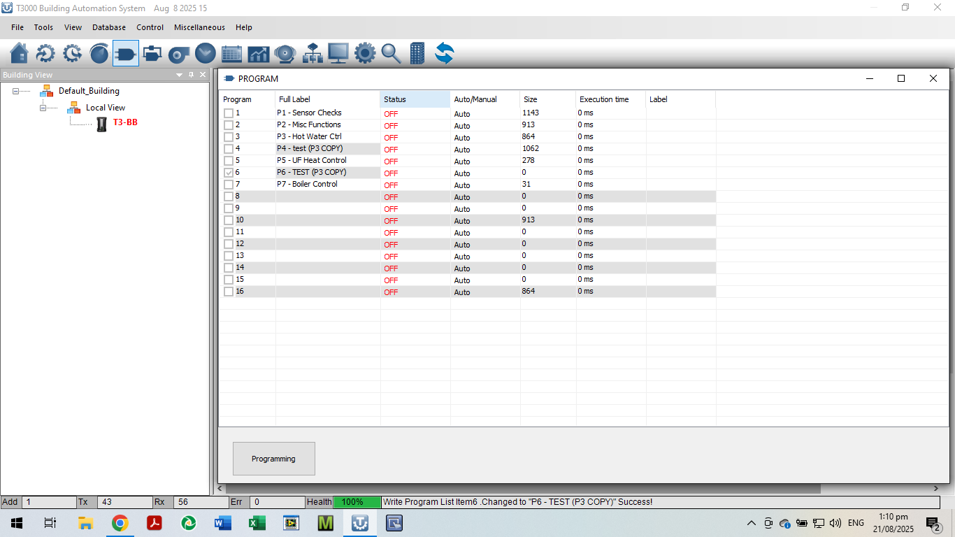

Attached is a screenshot of my “program” home page. Program 4 is the test copy of program 3 - but note the different size. Note also 100% health.

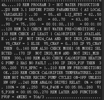

Also attached is the .txt file of PRG3 BLOCK3 21AUG.txt (1.3 KB)
  1. When you open your saved code and find that it has disappeared, the status bar at the bottom should display “decode error”.
  2. We need to resolve the issue where T3000 crashes directly when opening your program. Please provide the prog file to me. You can use “File - Save” to upload the prog file, and I need it to fix the compiler’s bug.
  3. After writing code that causes T3 to crash, to solve the problem of being unable to open it, you can try “Clear Device” in Configuration. Please use this button with caution, as it will restore most contents to factory settings.
