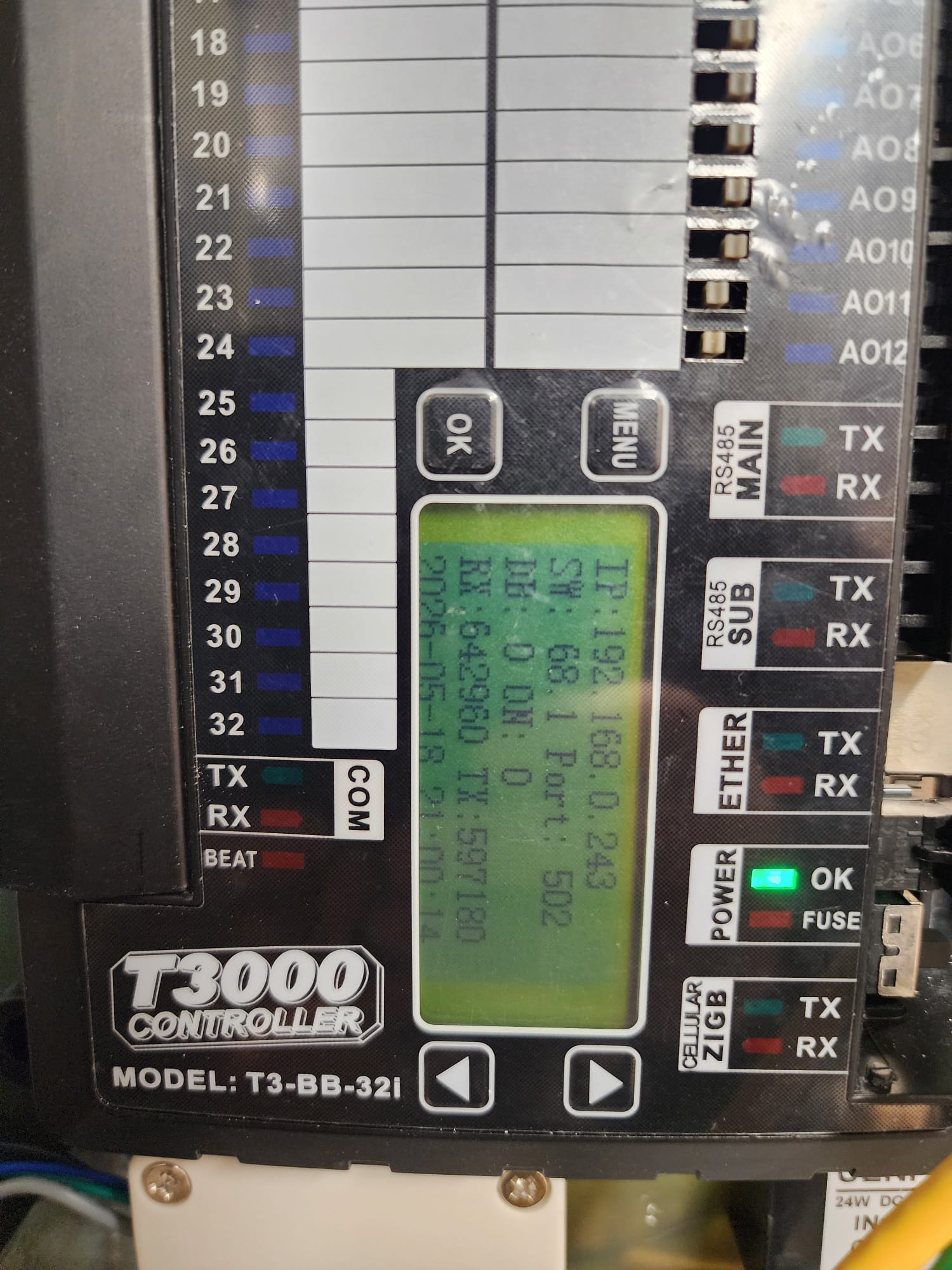

My T3-BB controller suddenly failed several hours ago. I was in the middle of some remote programming at the time

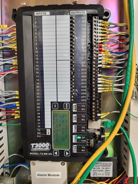

Attached photos show what I have:
Power light is on
Beat light is flashing normally
No Input or Output (blue) indicators on
No traffic in Ethernet or RS485 Sub
local LCD display shows normal content.
All outputs appear to have defaulted ON.
Is this controller recoverable? It is obviously not completely dead.
(I have ordered a replacement)

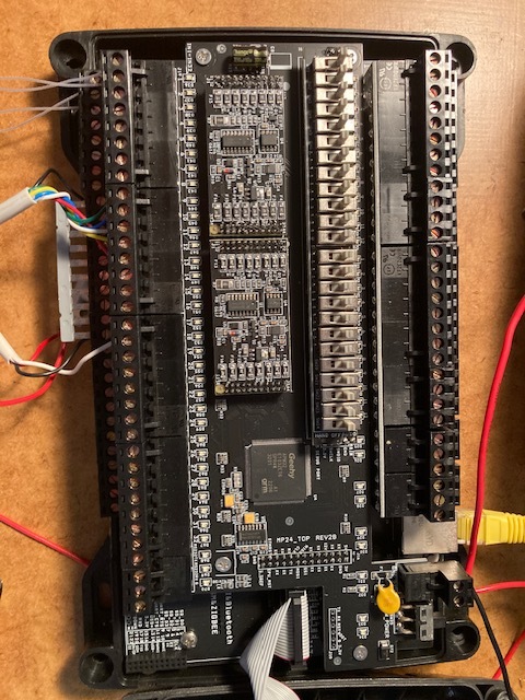

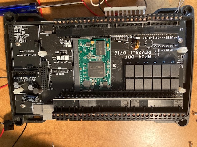

Photos of internals were taken about a year ago but show exact model etc

If this happens again I’d try swapping the CPU module, the top & the bottom boards with known good units and see if the problem follows one component or the other.
