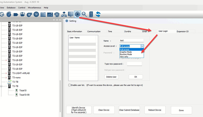

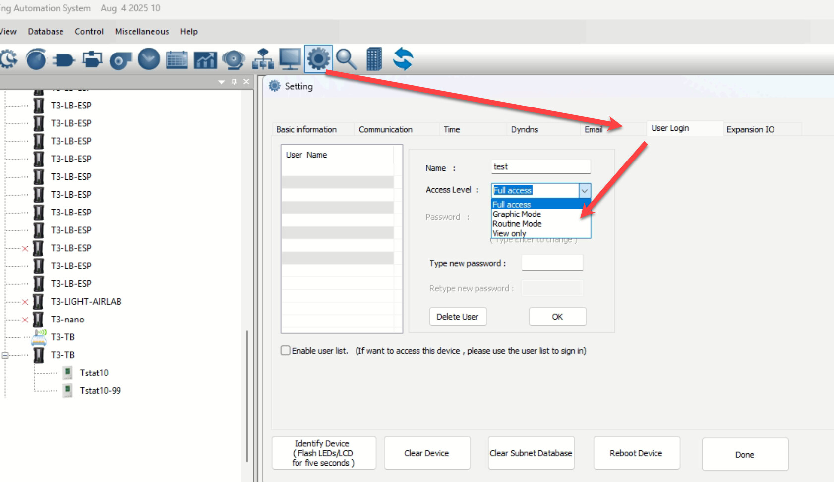

My project with my Temco controller needs to be protected by a password. Is there a way to protect the program in the T3-TB-11i/T3-TB-32i device? Which Temco models support the security function..
There’s some rudimentary security features for logging in and access levels. If you are looking to keep a certain program hidden there’s no features for that.
Thanks,
I want to prevent unauthorized access to copy or modify the program. I will look into the User login section.
