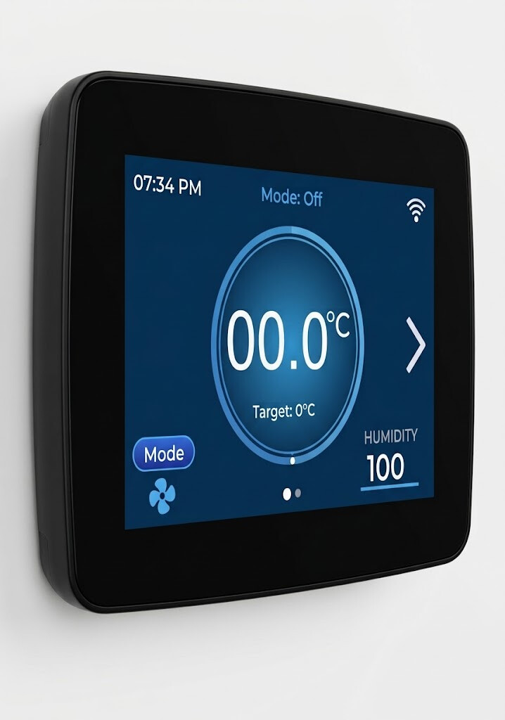

I would actually go with the Tstat11, it has 16 megs of rom and 8 megs of ram which is going to be handy to suport Sedona. Lijun will let us know how long till we’re sampling.
I dont have a decent photo but this is the general idea, AI generated from actual screen shots.
