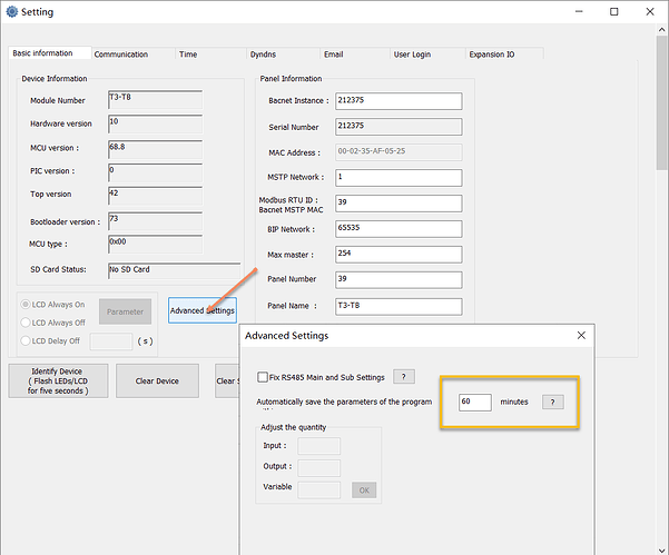

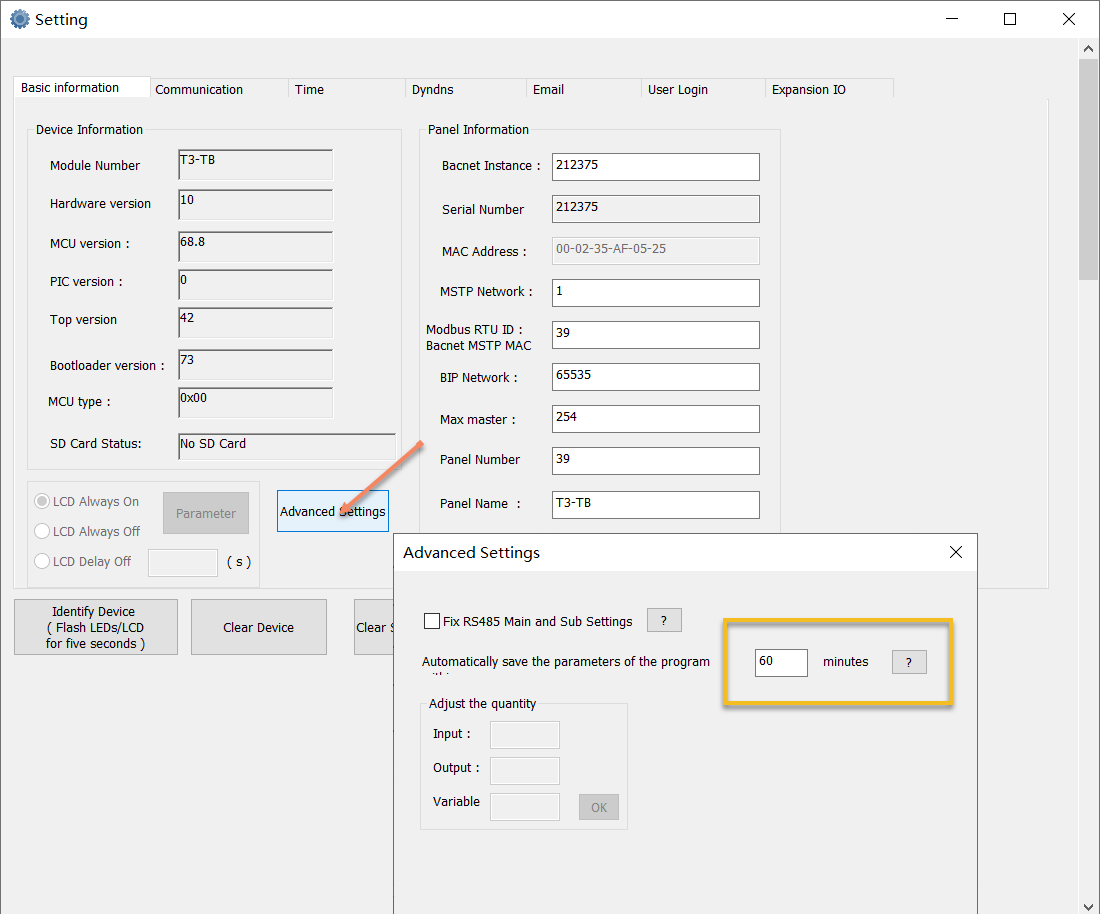

Yes, this function is available. Auto‑save can be configured. However, considering the service‑life limitation of flash memory, we generally do not recommend customers to use this feature. If you do use it, the minimum save interval is 60 minutes. The system will automatically save IN, OUT and VAR point data. Please refer to the screenshot below showing how to enable this function via T3000.

I will set up the auto-save feature for the upcoming project.
Chelsea confirms the RTC flash is there but its not battery/supercap backed unfortunately.
She has done some code to save on a periodic basis, 1 hour interval is the lowest setting which depending on what all is being saved, how often the data changes, this will give you a decade or so of flash life. After that there is a risk of reading bad data on power up in your vars. Other than that everything will run normally.
I’d double it to two hours to give you two decades. Chelsea will report back here shortly and the team will add the setting to the user interface.
