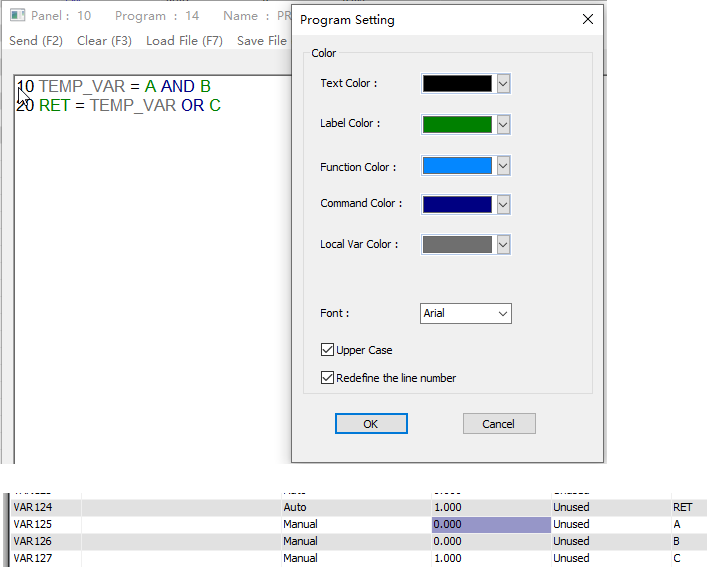

The result of my testing confirms that the operation priority issue in the firmware is exactly as you described. We cannot fix this bug in the short term.
Since this small BASIC programming system is a simplified version, I recommend you use temporary variables to hold intermediate results of the logical operations and make your program easier to understand.
Local variables such as TEMP_VAR in this example shows up in grey to confirm its a local varialbe.
