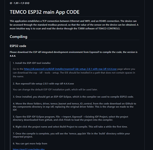

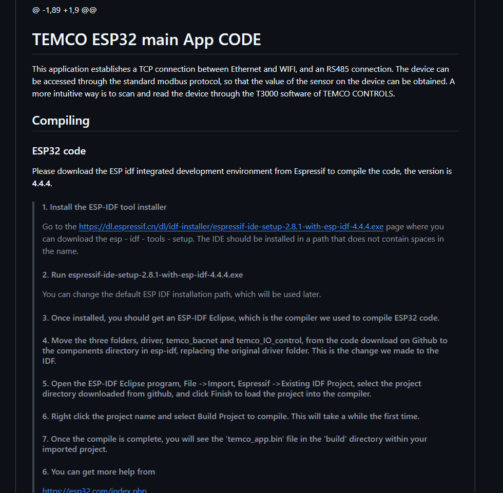

When I try to click the link to install the esp-idf 2.8.1 4.4.4 version, it says not found. Help
I found this reddit link with some troubleshooting steps. Let me know how you make out , our team is available if you run into problems.
