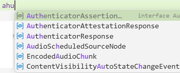

Agreed on the naming, 8 chars is not much to work with. I will make a todo in the development qeue for enabling the 20 chars in progamming, graphics and trend logs. While we’re add it we may as well add an intellisense autocomplete type drop down in the editor like so:
Maurice,
That would be a great tool!
Thank you,
Jim
