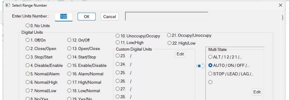

OK but can the display issue with types 101,102, and 103 within the T3000 software be corrected please? What is displayed in the units column as well as within the select range number popup does not reflect the actual multistate variable table values after an edit.
I have to apologize my previous note is slightly misleading. The displayed list does update after an edit, however, if you close the variable list and reopen it the values revert to the previous list. Perhaps the solution is a simple as making sure the description of the multistate variables is updated when the page is opened so it does not revert to a previously cached value.

Typical Var range selection window. Var1 is type 101 Var2 is type 102
This is the actual contents of the var1 multistate table
This is the actual contents of the var2 multistate table
If you edit a multistate table the correct information is displays in the range selection and var definition widows until the t3000 software is restarted at which point it reverts to the originally saved text. The Tstat10 appears to function properly

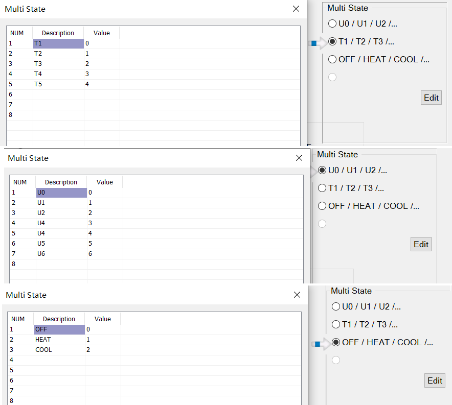

I loaded your prog file which had 0, 1, 2, 3, 4 filled in normally. I edited by adding 5, 6, 7, cycled power, all seems normal. I erased the prog file and reloaded it, all seems normal with all 7 states filled in. Here is my prog file with all three multi state variables filled in, try loading this to your controller.
