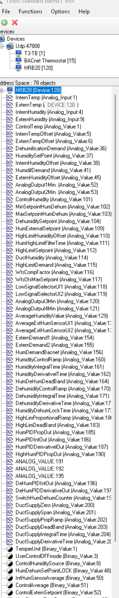

I have a TB-8i with a Neptronic HROB20 humidity controller on MSTP MAC 20, with an instance ID of 120, and a Contemporary Controls BAST-221C-B2 Thermostat on MSTP MAC 15 and a instance ID of 15. Port is at 38400 on all devices, comms are good:
SO! The Neptronic is reliable and DOES show up, and when I poll the variables, all is good :

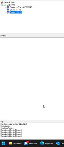

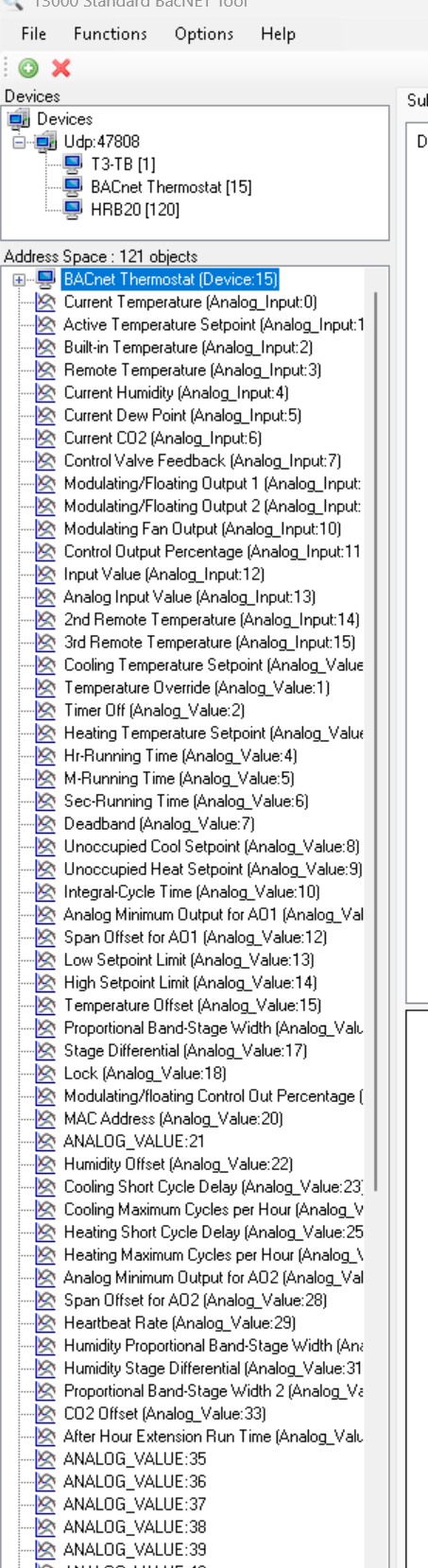

The Thermostat on the other hand will NOT show up under the device tree in T3000, and while I can send and poll using YABE launched from the T3000 application, But the YABE on my laptop on the same subnet (Windows 11, YABE version 2.10) can SEE the devices, but the WhoIS fails every time. Also, the variables do not update reliably.
So, two questions: 1.) Did I miss a step with the thermostats? 2.) How the hell do I write to the variables? I can read AI’s, AO’s, BI’s, BV’s, and MSV’s, but cannot write to them from the T3000 interface, whether it is in auto or Manual mode. I am assuming that I am doing something wrong. I have just ordered two TB tiny’s to use as BACnet routers as opposed to the Contemporary Controls BASRT-B’s that I normally use, as I have a location that we want to add 100+ TB tiny’s as routers. For an HMI, we use both a Weintek HMI as well as BASView 3.

Hi Lijun, thanks for the quick reply! I did update the firmware, but I was already quite up to date. The thermostat is quicker to respond now, but unfortunately, when I try to discover anything from YABE on the network, the mstp devices do show up, but will not acknowledge or return points:
They also do not appear on our BASview server, but the TB does!

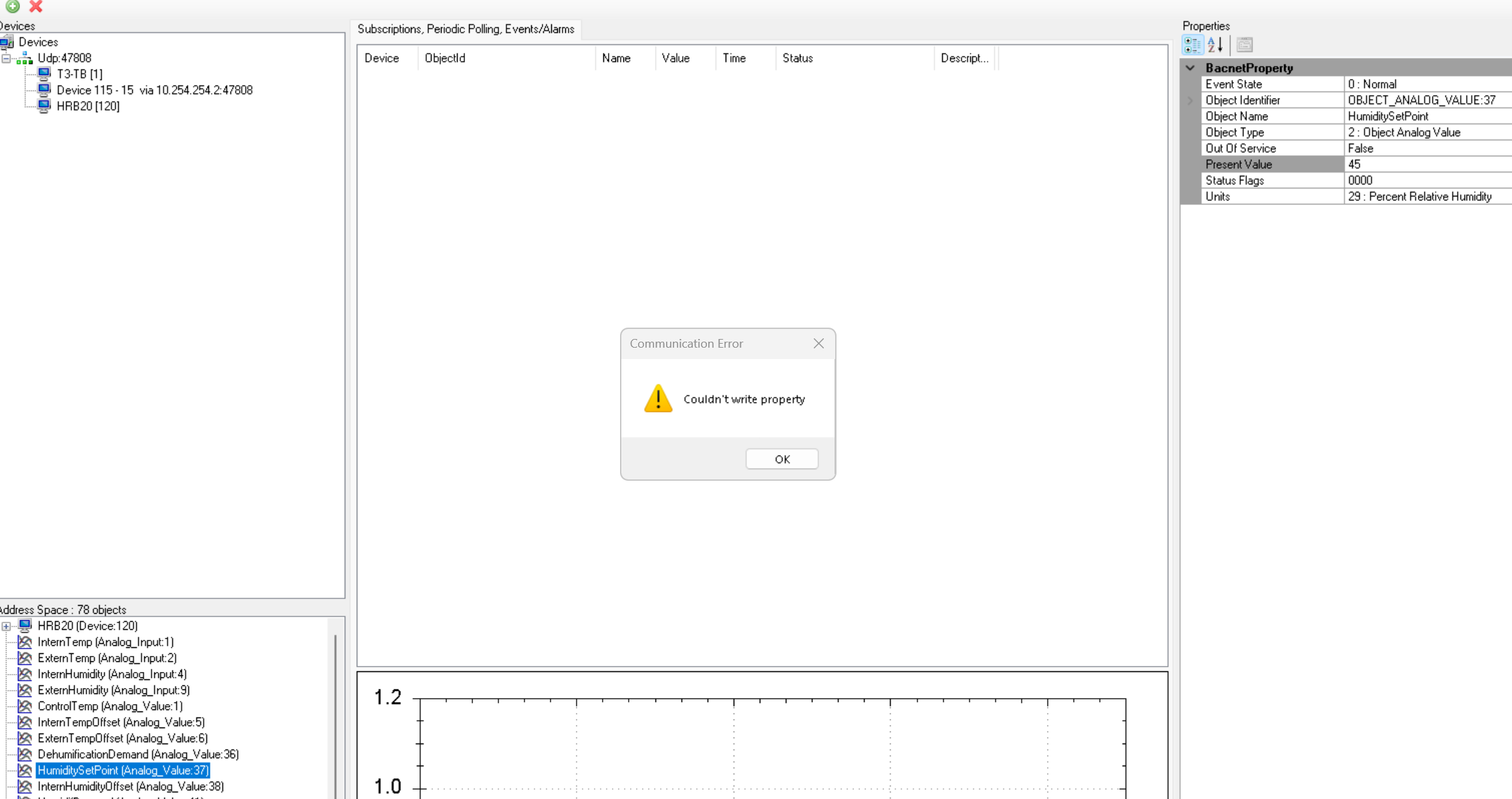

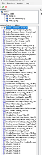

So I have updated all of my devices, by adding a 1 in front of its MAC address, so ID 15 has a bacnet id of 115. I have updates of all network points within a few seconds of modifying the point on the device. When I try to update the setpont from the variable screen, by putting the mode to manual, and setting the SP to a different value, it does not update that value on the device. When I set it via YABE in the T3000 tool, it does update the value on the controller, but tells me it has not:
Any Thoughts? I am trying to cover alll of the possible issues here, and am using two different BACnet certified devices in order to keep all of this BACnet compliant.

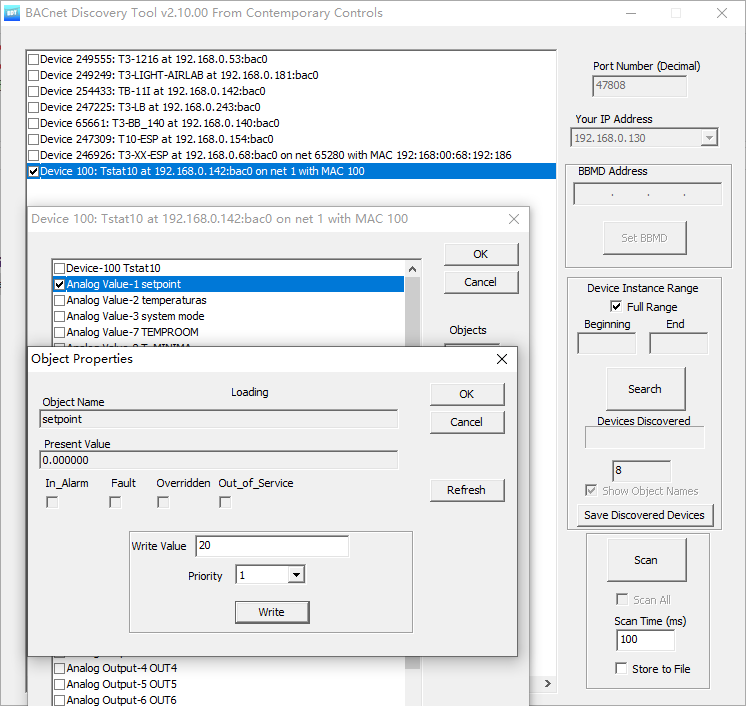

We usually use Yabe for the basic tests, and everything goes smoothly. The following is the result of my test using the software from Contemporary Controls, and it can indeed be written to normally. Are you writing about AV or another object? Not all parameters can be written. Could you provide me with more details?
