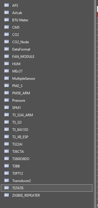

I am confused about the tstat10 register map. Per other discussions on the forum, i am looking at the RegistersListDB.mdb. My file has the following tabs:
I do not see a list for the tstat10.

Should I be using the tstat8 list?

Which T3 should I use? In the DB, i’m seeing 9 variants (see screenshot on OP).
Use T3BB.
TSTAT10 register map is the same as the T3-BB. We’ll be updating the documentation shortly.
