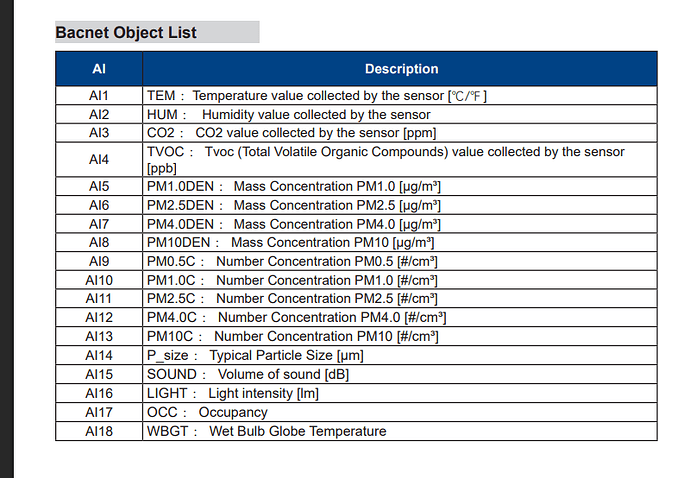

Modbus address for VOCs on Airlabs weather station
Is not stated in manual, only for BACNET. Anyone know the address for this value?

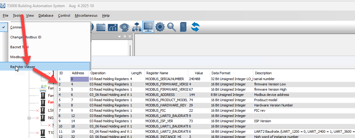

In general or modbus register info you shold use the modbus register tool in T3000. Its maintained better than the PDFs with respect to the modbus register list.

Updated. Please take a screenshot
The register list is very long ,it can be downloaded as an excel spreadsheet(03ModbusBac
netRegisterList.xls AirLab )
https://temcocontrols.com/ftp/software/03ModbusBacnetRegistersList.xlsx
