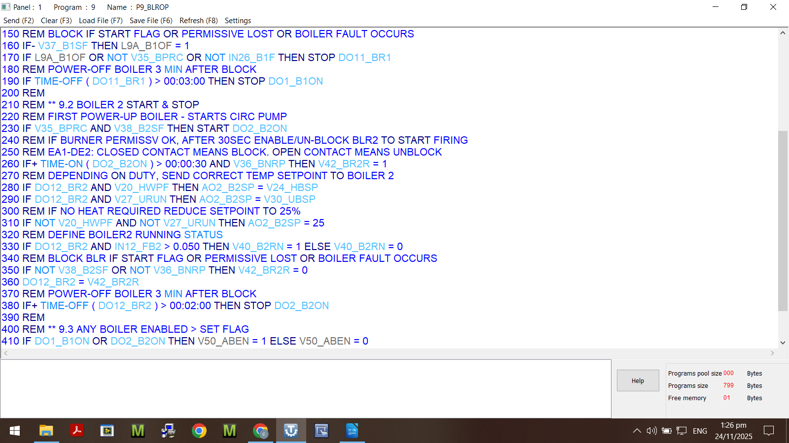

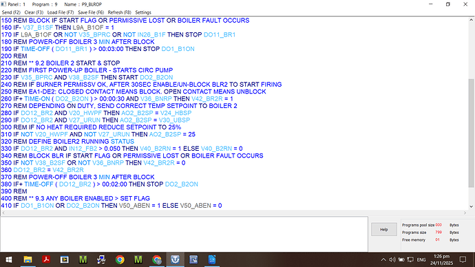

In the program window, there is summary of bytes used etc - see below. The size field can only have 3 digits - so when size as above 999 bytes, the leading 1 does not show. There is ample space available to include the leading 1.
In the screenshot, the Program shows as 799 in the summary but is actually 1799.
