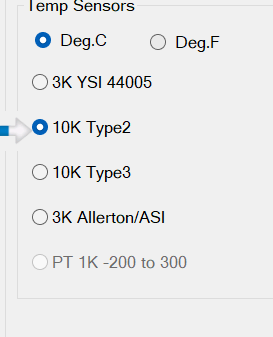

I have DTS 1K Type Sensor. Need to connect T3-OEM controller, but in “Input Settings” I cant choose 1K type Sensor.
Correct, the T3-OEM doesnt have the 1k Pt additional hardware. It was designed for a client wanting a bare bones controller. If you had a ‘good size’ project we could customize it for you.
Oh, I see. Customization would be great, but I need to ask my company if they dont want to switch to a different solution.
