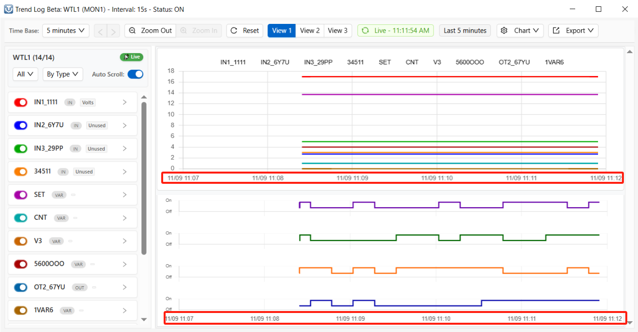

This is definitely the direction we’ve been heading. The team has been adding a feature within T3000 to log the entire system to the hard disk in the background. This will log all inputs, outputs and variables in the system on ALL the controllers in the building to the local hard disk. The next logical step will be do to as you mentioned, send the data out as an OPC server. You can count on seeing this in the next month or two, we’re focused on this these days.
Note: This will run on a win11 PC in the building, not directly on the T3 controllers. A raspberry Pi would be a good candidate platform to run the OPC server when it becomes availabe, here’s a link on how to set that up:
