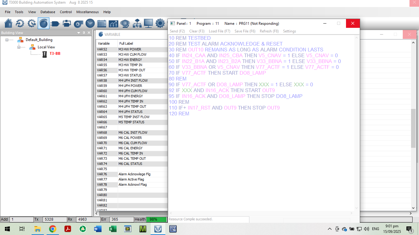

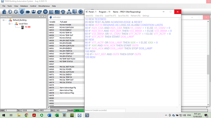

Typically, I click on send and nothing happens…but the screen freezes, then I click again. After 2 extra clicks the screen banner shows “Panel 1 Program N Name [name]: (Not Responding)”.

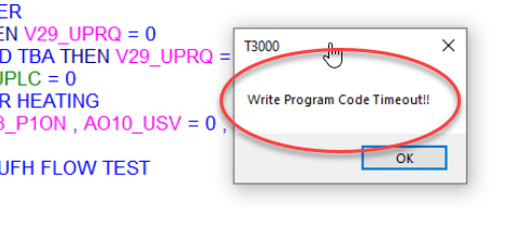

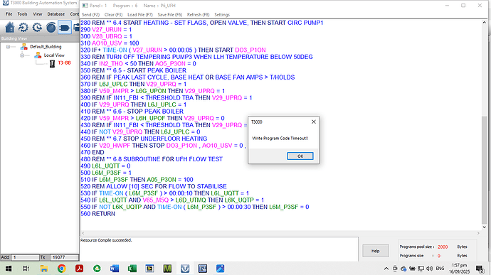

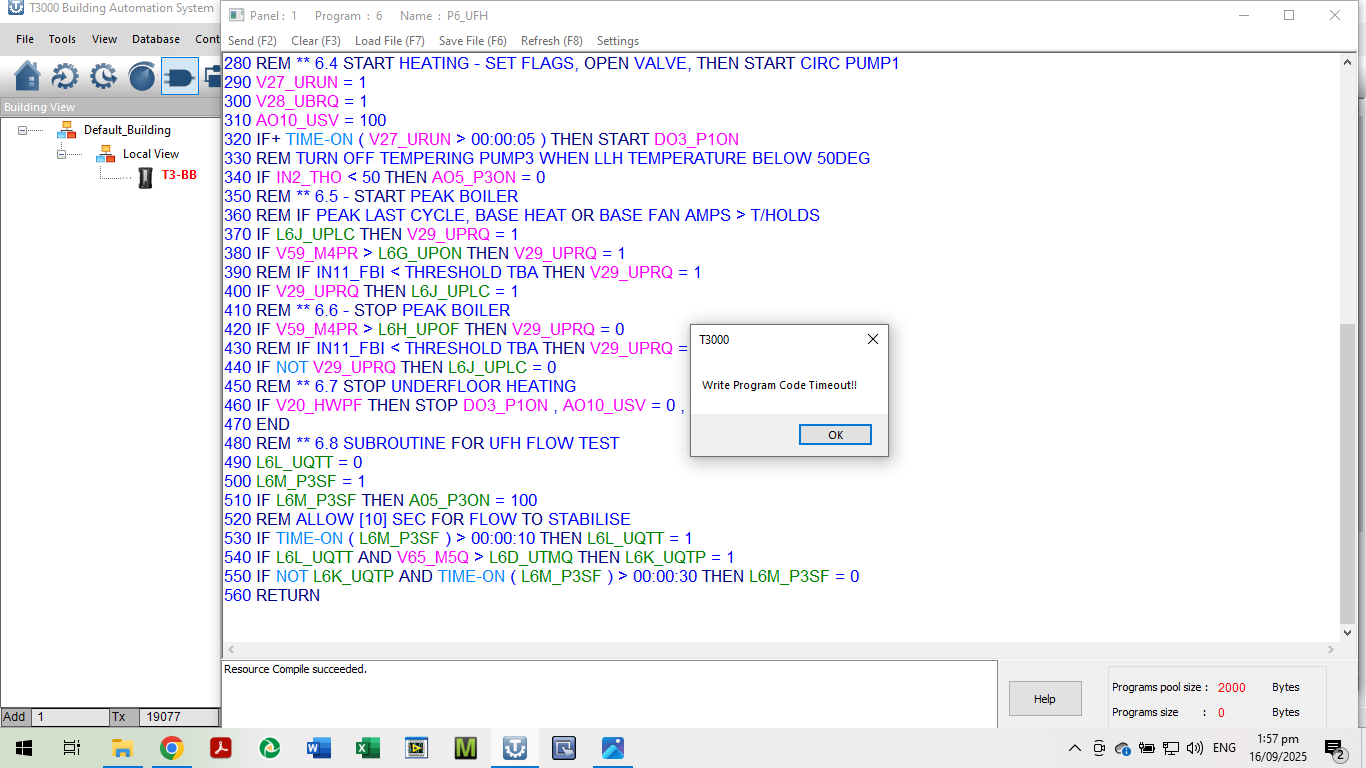

I click again and the hourglass shows, another click and the program window becomes “washed-out”. Then after about 40sec a pop-up/beep says “Write Program Code Timeout”.

(see screenshots)
