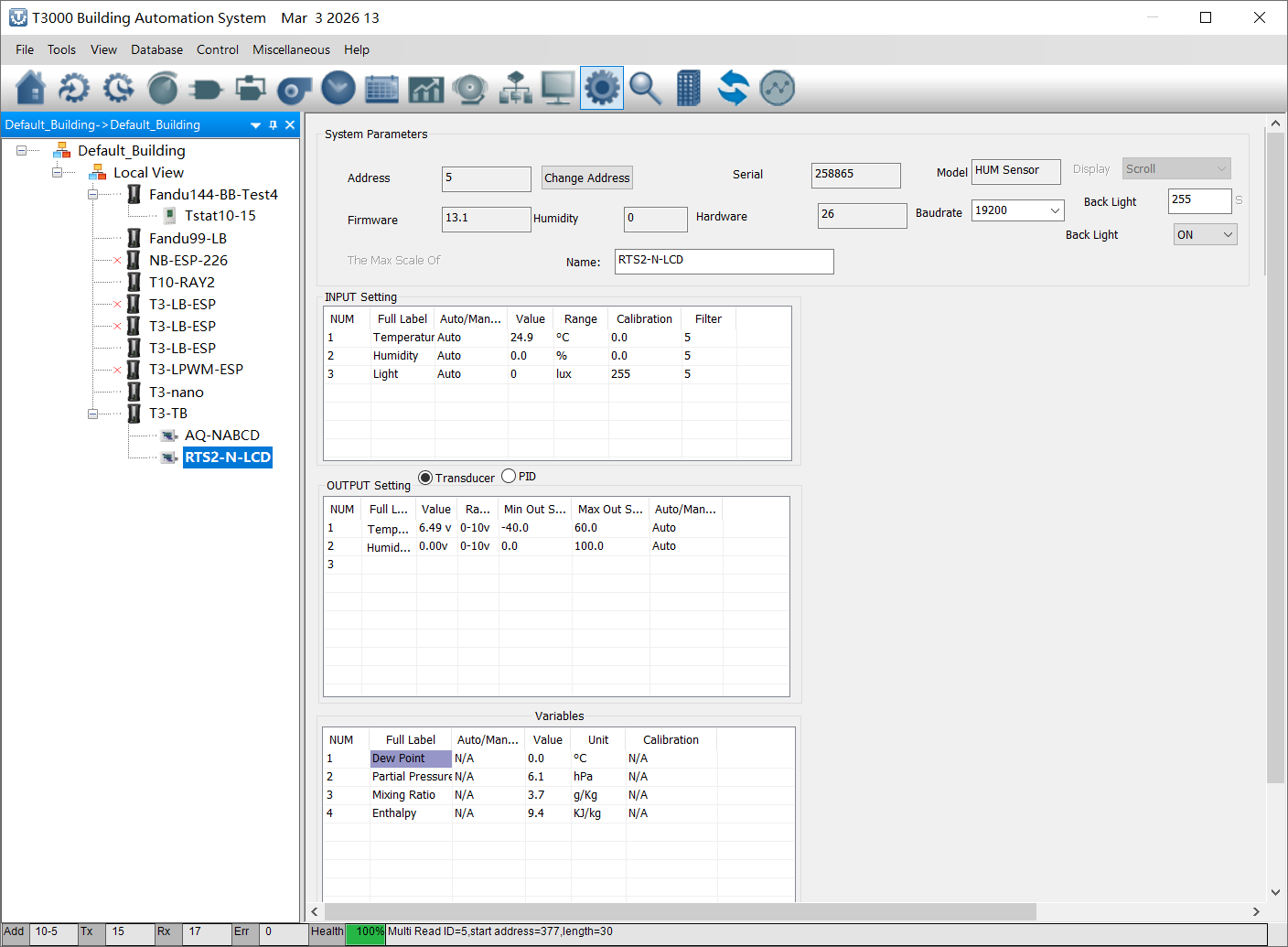

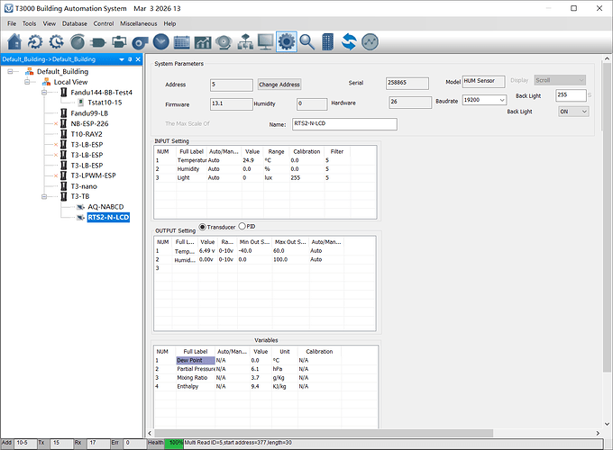

We just tested the RTS2-N-LCD here and can confirm it does communicate in T3000 and has a proper interface. This looks more like a communication setup issue.
Since you also mentioned it is not stable even when connected directly to the PC, that points even more toward communication settings or wiring. If you can post the RTS2 settings, T3-LB serial settings, and wiring, we can help check it further.

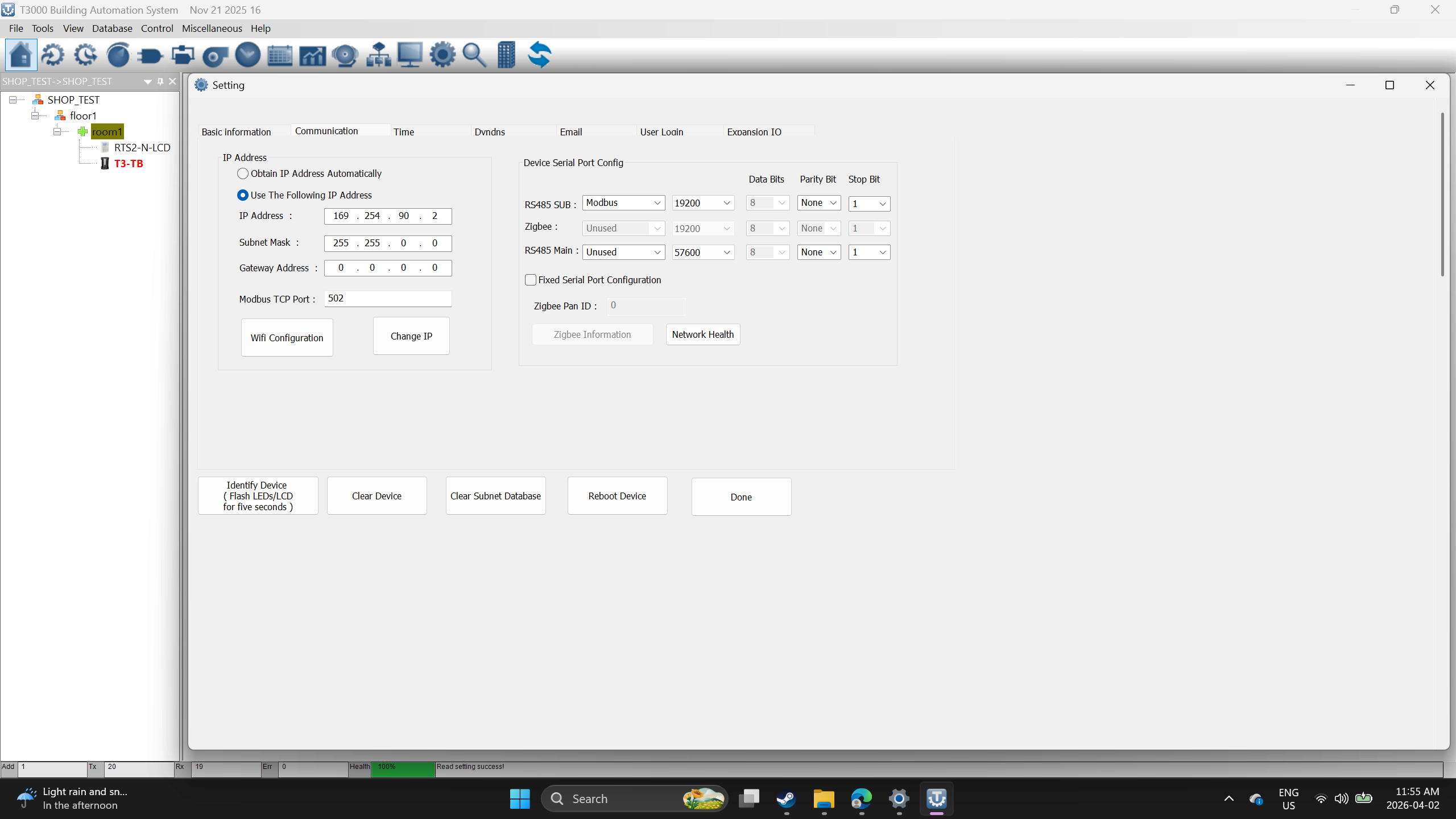

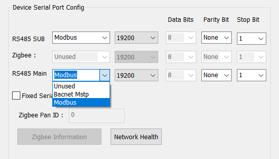

If you connect to the T3 over Ethernet, then open the T3 Settings > Communication page and set that RS485 port to match the device you are connecting, including the protocol (Modbus or BACnet) and baud rate, T3000 should be able to find the device automatically and show it under the T3 in the device list.
For now, I would test with just one RTS2-N-LCD on the port, make sure the address is unique, and keep the protocol and baud rate matched on both sides. Since you also mentioned it is not stable even when connected directly to your PC, that still points more to a communication setting or wiring issue than a T3000 limitation.
If you can post a screenshot of the RTS2 communication settings and the T3 communication page, we can take a closer look.

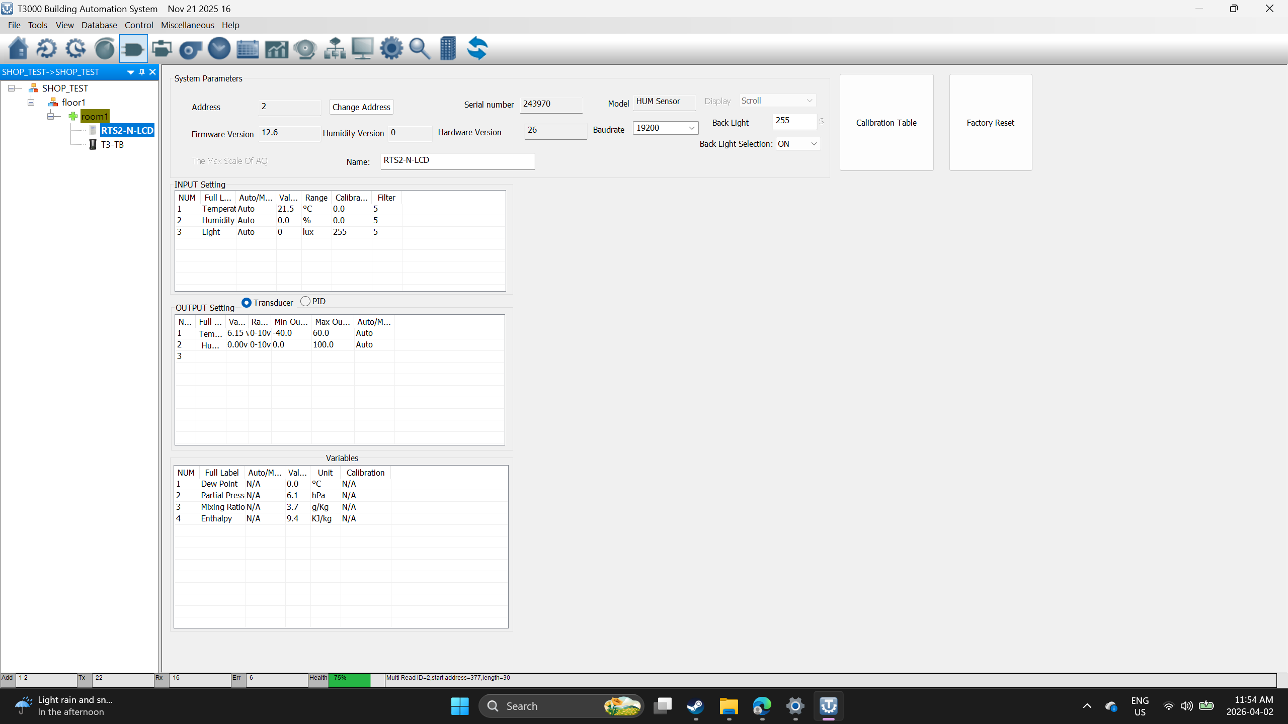

Thanks for the input. I was able to get a T3-TB at my office to communicate with an RTS2. I still could not get the T3 to recognize the RTS through 485 by itself, I ended up connecting a usb/485 adaptor to both the controller and the RTS from my laptop, as well as connecting the laptop to the T3-TB with ethernet. Everything showed up on then network tree then, and I disconnected the laptop from the 485 network (not sure if RS485 likes hot swapping, but it worked?), and now everything is visible with just the ethernet connection, and I can read registers from the RTS2 now (have not tried switching to bacnet).
I’ll attach screenshots of my settings, but I think I have everything set so it should communicate? I’ve tried a few different RTS2’s and T3’s and have similar issues, so I think it’s likely a user issue.
