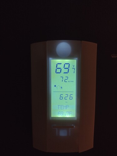

All my hardware is the same REV22 18.05.04. 1 of 4 will allow buttons on 11.4 or 11.5. 4 of 4 allow buttons on 8.9 or 9.0. I have found no combination that the schedule works correctly. They either will not go into unoccupied or will not return from unoccupied. When this happens the icons on the Stat do not match the information on T3000. I have also seen the stat to go a mode where it says the setpoint is 999. then usually goes back to a normal mode after a short period. If that gives us any clues.

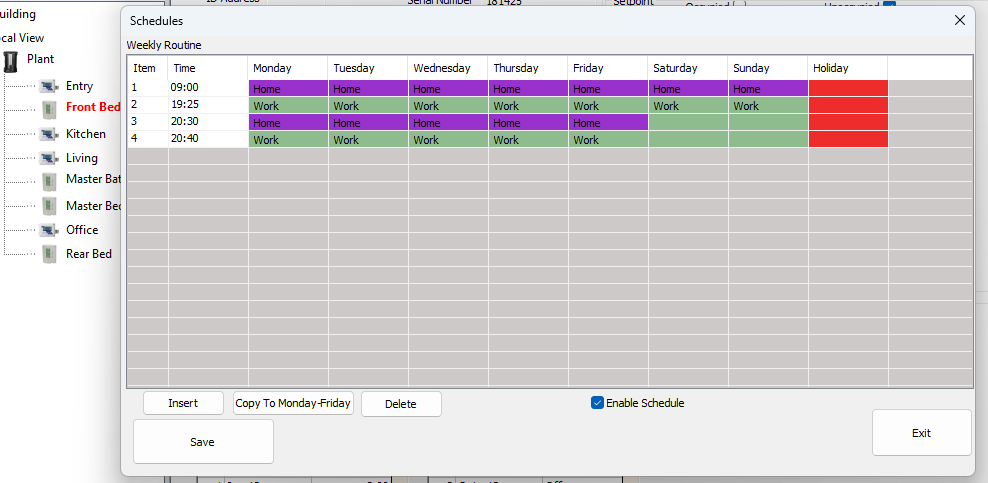

I updated T3000 and flashed the Stat7s to 11.6. Stats still will not follow schedule. Not even the one that the buttons work on. They are all staying in Occupied no matter what schedule I put in. Here is my config file.

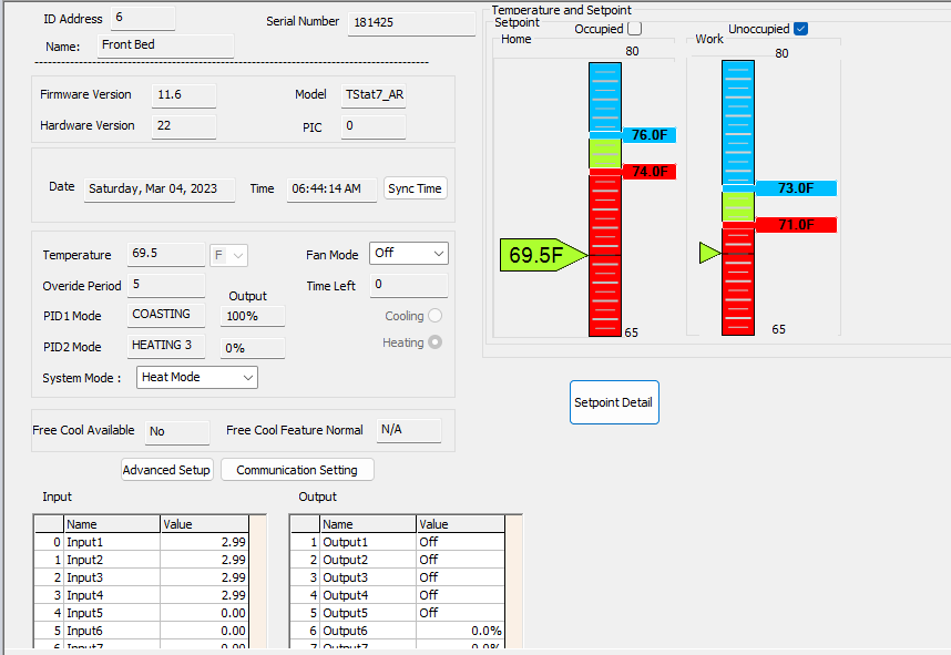

All was well then in the mooring I saw the thermostats showing 999 setpoint. Briefly toggled to the correct unoccupied setpoint and back to 999. I did not have time to open T3000 to see what it thought was going on.
This is what I see from T3000 when this is happening. You can see the loop and output are not responding.
FBR rev11.6 3-4-23.txt (14.8 KB)
Update: The Tstat7 supports only occupied and unoccupied modes, the user interface will now correctly not let you use the home and away modes, these are specific to the Tstat8.
