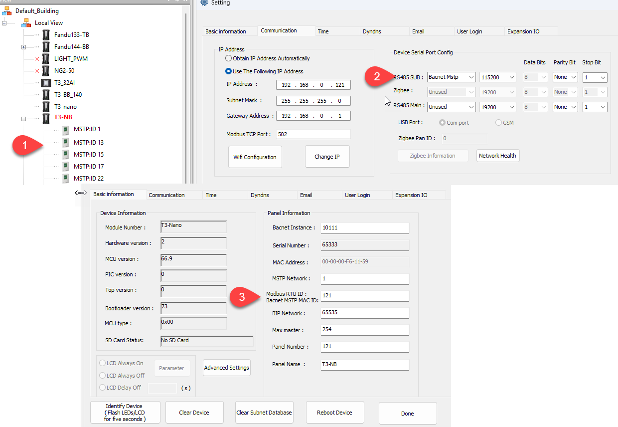

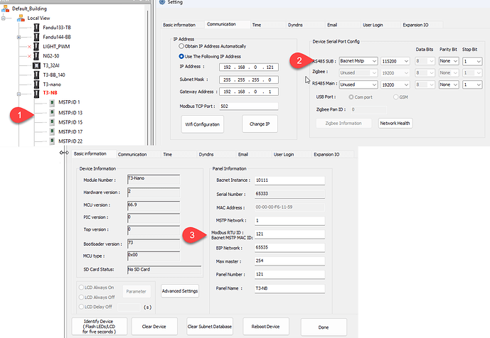

To connect HMI panel to T3-BB via RS485 Modbus I need the Modbus slave ID. Is there a default value? Can it be changed to a custom ID number?

I am not sure what th edefualt is but there’s plenty of tips on the forum here for connecting devices directly and also via subnet. The basic settings you need to pay attention to are the protocol, baud rate, network ID.
T3000 is pretty good at scanning and discovering devices no matter the baud rate or protocol settings.
Reduce the test setup to go one to one if you are having trouble, as in one PC, one RS485 converter, and one device.
