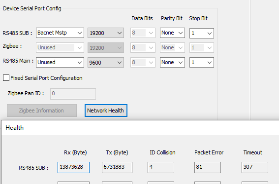

Make sure RS485 port on T3-Nano is set to BACnet MS/TP and baud rate matches CO2-N.
Also check for “ID collisions”. If two devices share the same MS/TP ID, communication will fail. In T3000 → T3-Nano → Communication, open “Network Health”, any collisions will show up there.
If you see a collision, the easiest fix is to connect directly to the CO2-N with YABE and change its BACnet ID to a unique value.
