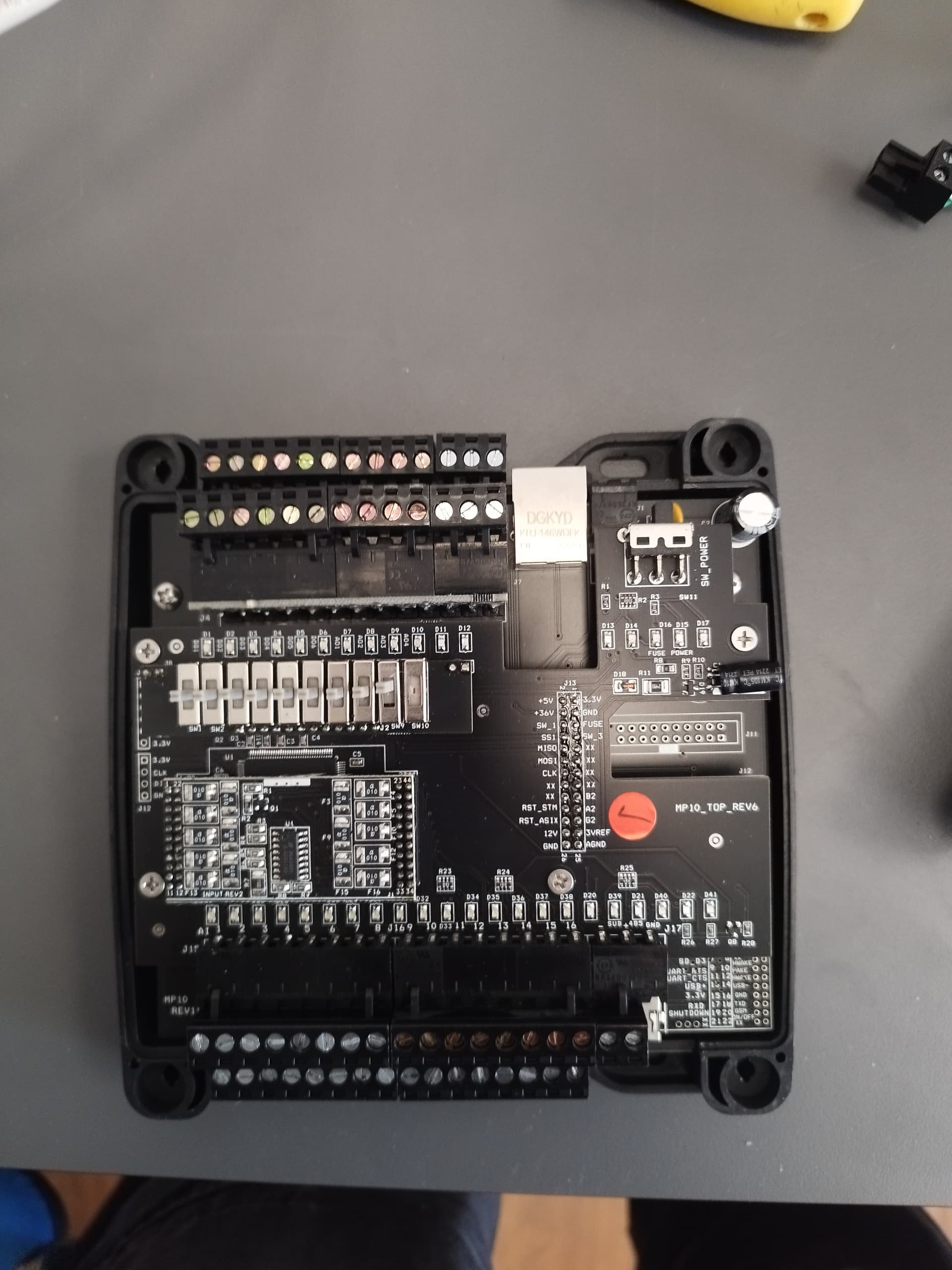

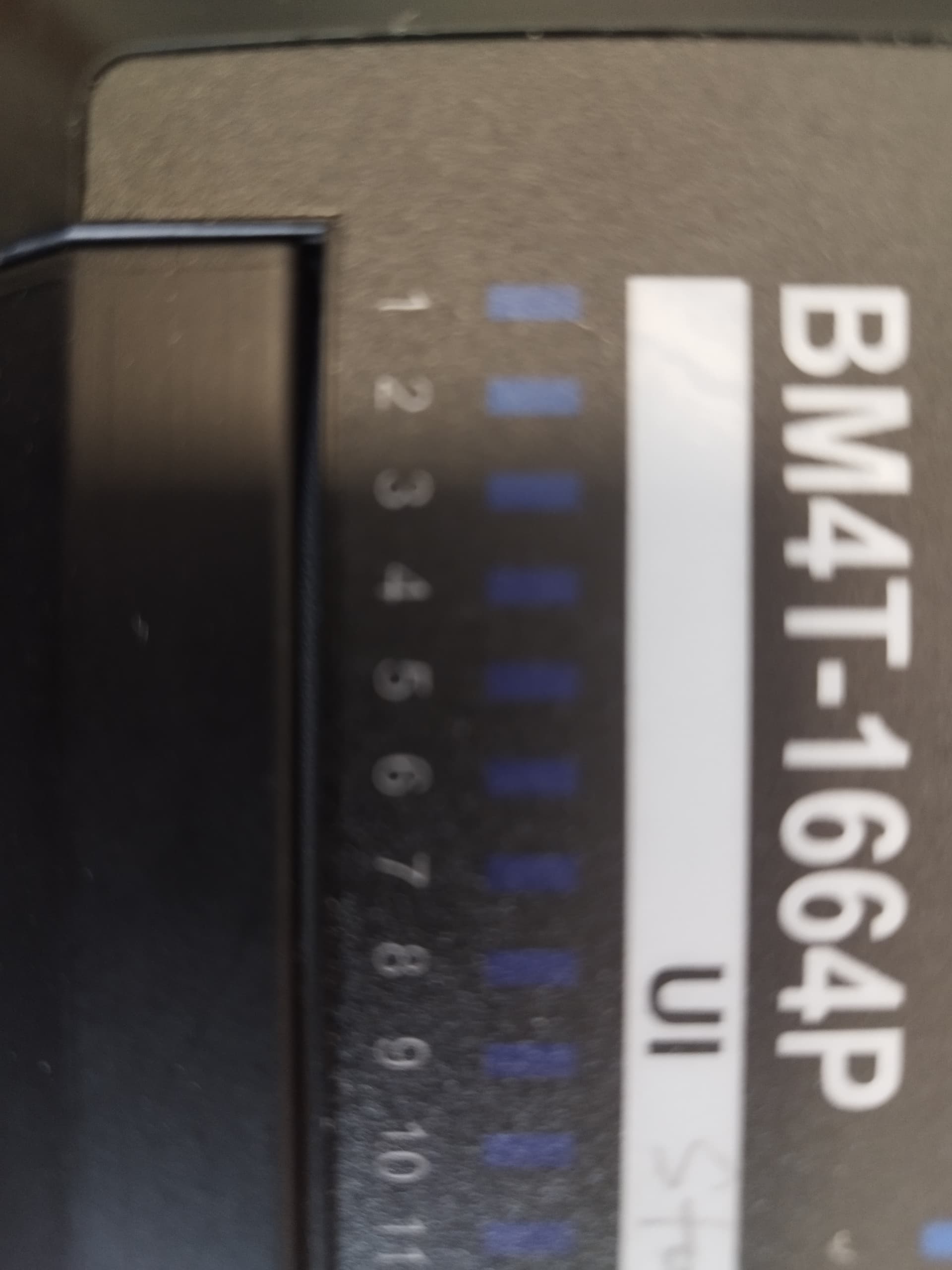

I faced problem with set up IP adress at that kind of controller.

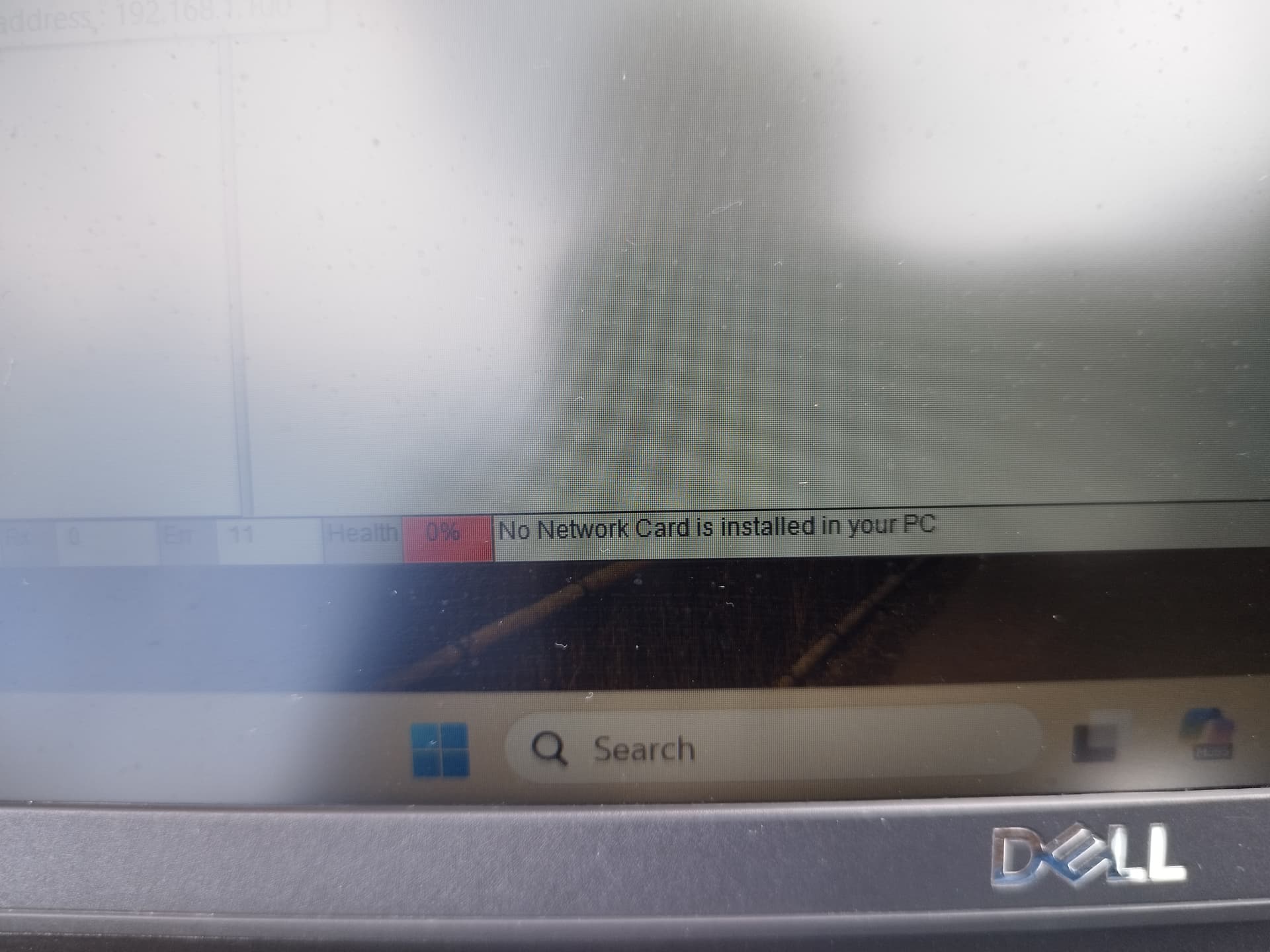

What does the step of Ip change I need follow??and after few times i changed it didn’t got the message and i could ping the controller.

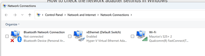

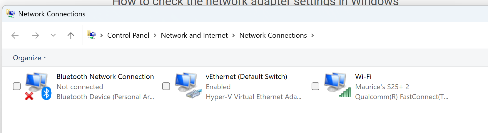

This means T3000 cannot find a valid network adapter.
If you have a VPN enabled, please turn it off and try again.
You can also try restarting the PC.
If possible, please send a screenshot of your network settings.

Lijun’s tips about your network card are your best best. Turn off any vitual adapters, wifi connections and so forth. If you are operating in a virtual environment try a simpler setup to get started. Show us the network adapters on the system.
