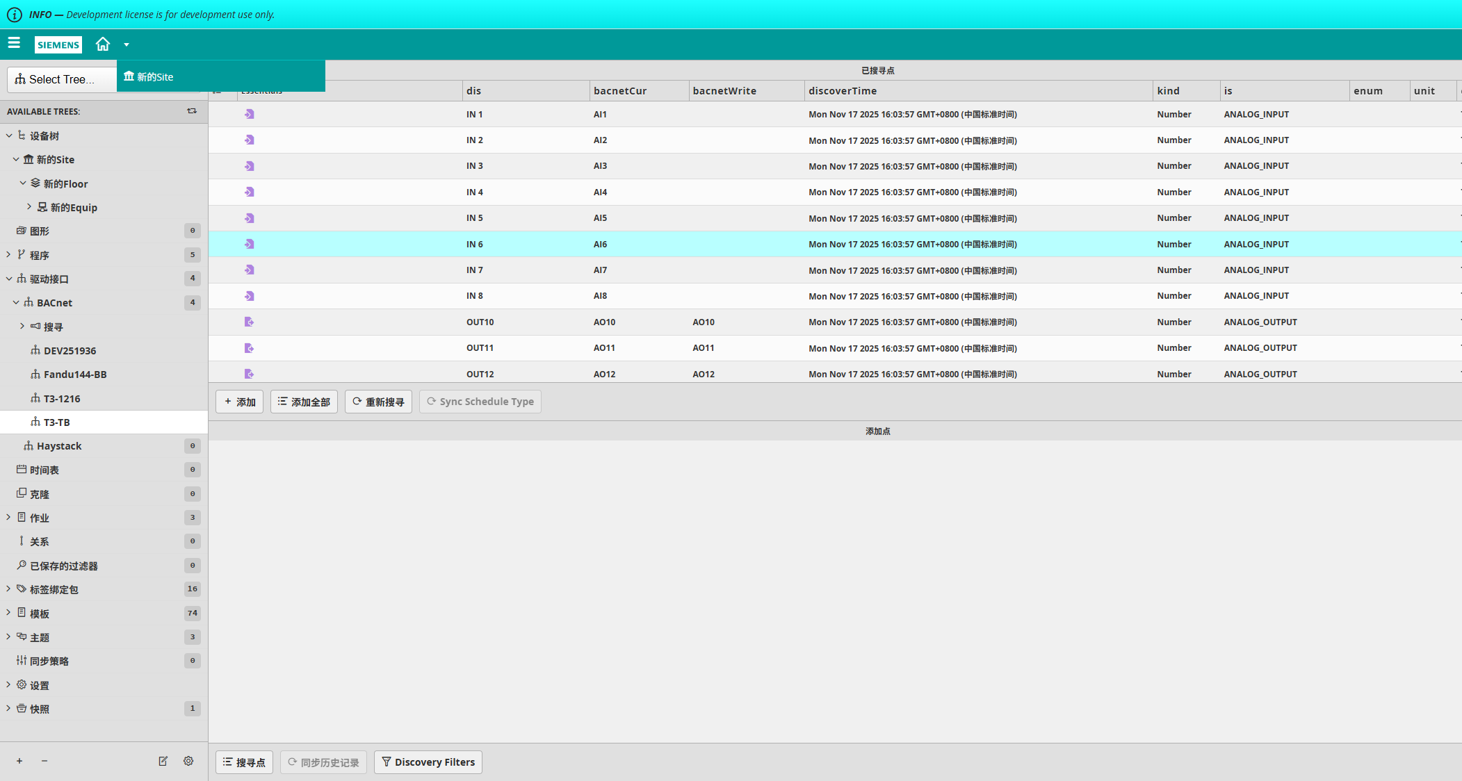

Thanks, we will apply for the trial version. I did not find problem in Yabe.exe, you could do some tests with that to cross check your results, its available with our T3000 → tools → bacnet tool.
Please post more clues like screen shots, traffic logs and so on.
I have applied for the trial version and used it to test rev67.8. I didn’t find any abnormalities. For the specific details, you can contact me via email. chelsea( at) temcocontrols(dot)com
