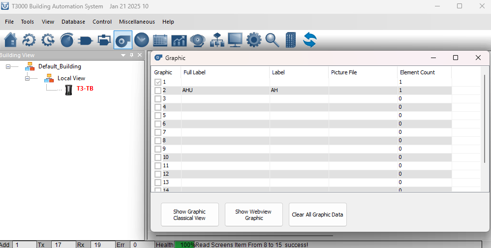

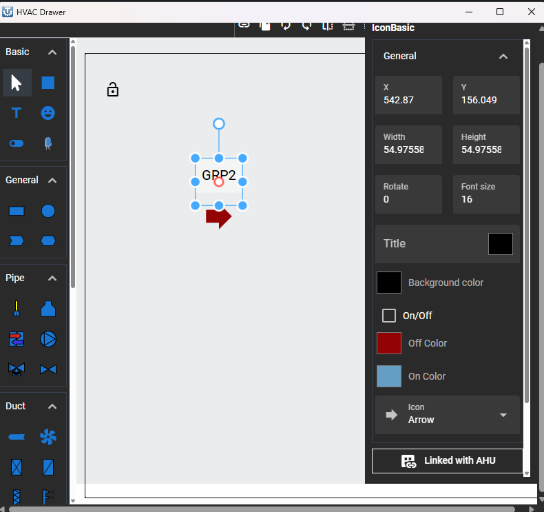

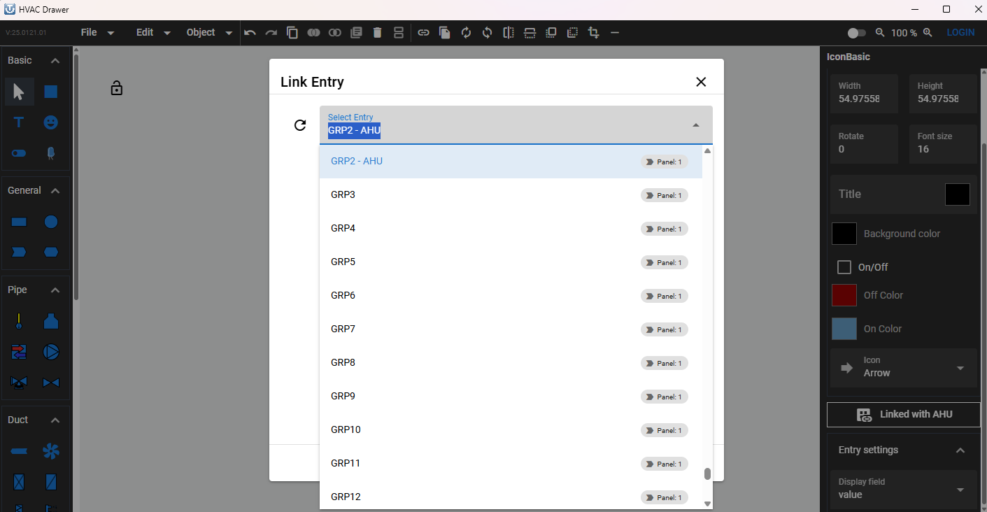

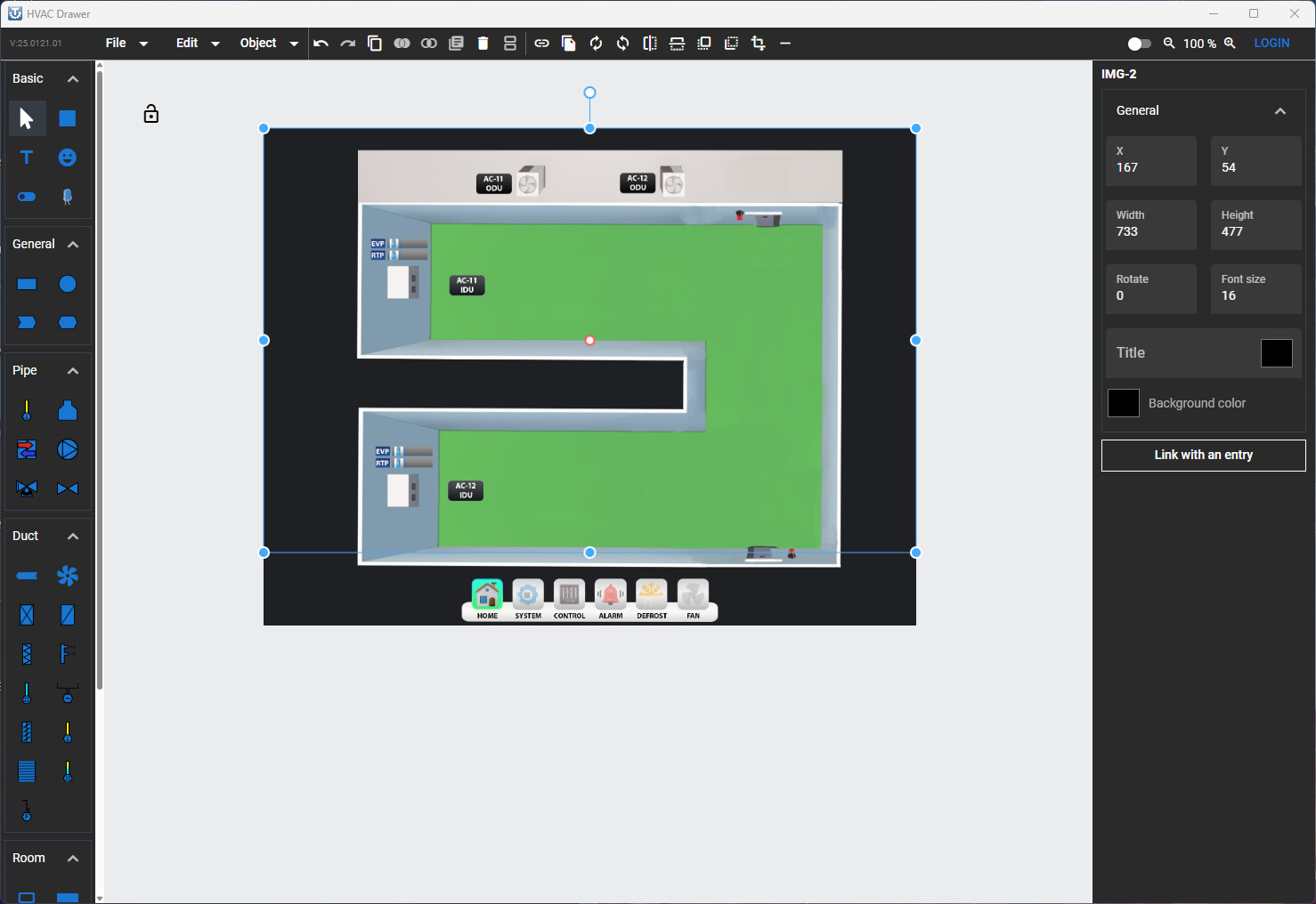

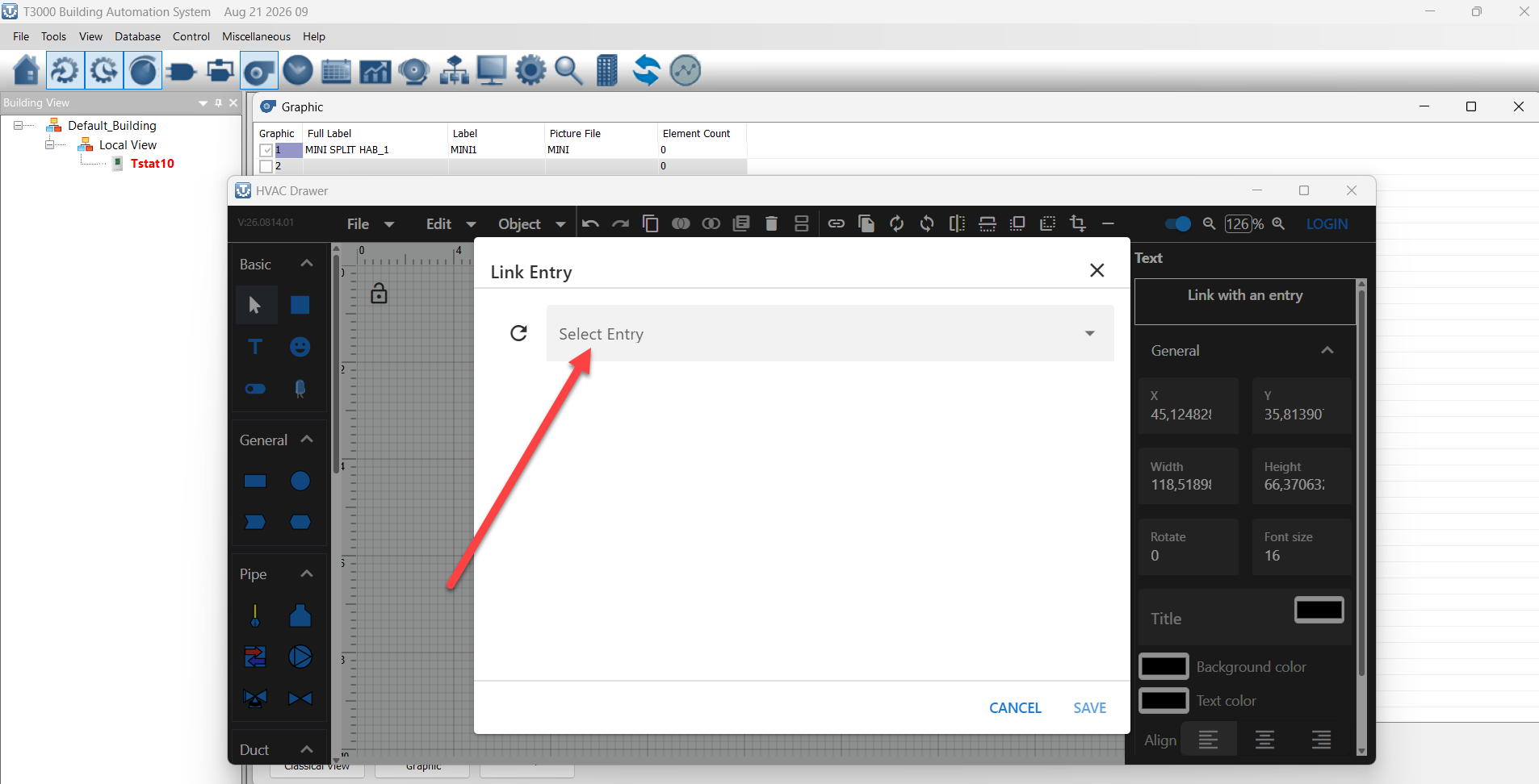

I’m trying out the Webview inside the T3000 software. However, I’m having some trouble with the changing graphics screen function. My current setup is I have two graphics screen, 1 and 2. In the first screen, I have an arrow icon that is linked to the second screen.

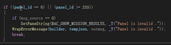

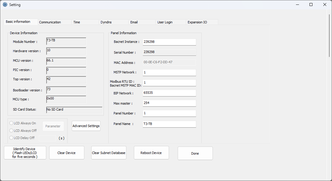

However, when I click on the arrow, the screen is not change to the 2nd graphics, and the T3000 software display an error message “Panel is invalid or index is invalid”. The T3-TB device panel number is set to 1.
4

Hi, good day.
Could you please share all the files under the \T3000\ResourceFile\webview folder? We want to perform a simulation in your environment.
